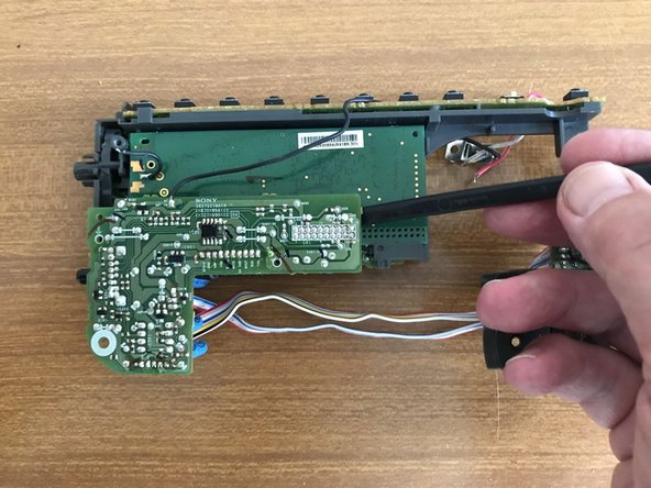

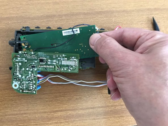

  6. Sony XDR-S50 DAB Radio DAB Module Removal, Sony XDR-S50 DAB Radio DAB Module Removal: crwdns2935265:06crwdnd2935265:01crwdnd2935265:03crwdne2935265:0 Sony XDR-S50 DAB Radio DAB Module Removal, Sony XDR-S50 DAB Radio DAB Module Removal: crwdns2935265:06crwdnd2935265:02crwdnd2935265:03crwdne2935265:0 Sony XDR-S50 DAB Radio DAB Module Removal, Sony XDR-S50 DAB Radio DAB Module Removal: crwdns2935265:06crwdnd2935265:03crwdnd2935265:03crwdne2935265:0
    • Unsolder the connection on thecircuit board to the DAB tuner module below.
    • Remove two screws marked on the circuit board (marked on the board with arrows).
    • The circuit board is attached to the DAB radio module beneath by a multi-way connector. Gently lift the right hand side of the board in order to release it.
    • The DAB radio module will now simply lift out.
  7. Sony XDR-S50 DAB Radio DAB Module Removal: crwdns2935265:07crwdnd2935265:01crwdnd2935265:01crwdne2935265:0
    • You can now inspect the DAB module.
