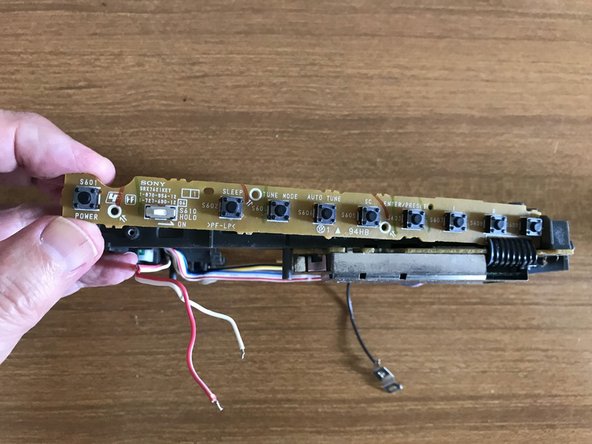

  6. Sony XDR-S50 DAB Radio Button Replacement, Buttons board removal: crwdns2935265:06crwdnd2935265:01crwdnd2935265:02crwdne2935265:0 Sony XDR-S50 DAB Radio Button Replacement, Buttons board removal: crwdns2935265:06crwdnd2935265:02crwdnd2935265:02crwdne2935265:0
    Desoldering Pump
    $3.99
    • Remove two screws holding the buttons board to the midframe.
    • Lift the buttons board from the power button end, and release the other end from beneath a retaining tab.
    • On reassembly, ensure that the right hand end of the buttons board is correctly located under the tab, otherwise the assembly will not fit back in the case.
    • If required, you can now unsolder and replace any of the buttons. For this, a desoldering pump is most effective.
    • Replacement 6x6mm tactile buttons are widely available in a range of heights. The 5mm height should fit, but lay a ruler along the tops of all the buttons to check the height before soldering a replacement.
