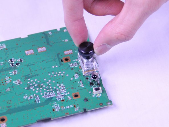

  14. Sony XAV-AX100 Volume Knob Replacement, Volume Knob: crwdns2935265:014crwdnd2935265:01crwdnd2935265:03crwdne2935265:0 Sony XAV-AX100 Volume Knob Replacement, Volume Knob: crwdns2935265:014crwdnd2935265:02crwdnd2935265:03crwdne2935265:0 Sony XAV-AX100 Volume Knob Replacement, Volume Knob: crwdns2935265:014crwdnd2935265:03crwdnd2935265:03crwdne2935265:0
    • Remove the silver knob cover by pulling upwards on it.
    • Remove the plastic face plate.
    • Pull off the black knob.
