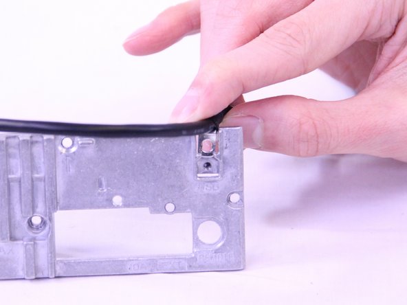

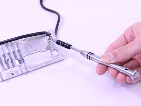

  5. Sony XAV-AX100 USB Cable Replacement: crwdns2935265:05crwdnd2935265:01crwdnd2935265:03crwdne2935265:0 Sony XAV-AX100 USB Cable Replacement: crwdns2935265:05crwdnd2935265:02crwdnd2935265:03crwdne2935265:0 Sony XAV-AX100 USB Cable Replacement: crwdns2935265:05crwdnd2935265:03crwdnd2935265:03crwdne2935265:0
    • Remove the 3.5mm Phillip #0 screw that secures the USB cable to the back panel.
    • Pull the USB cable off of the back plate.
