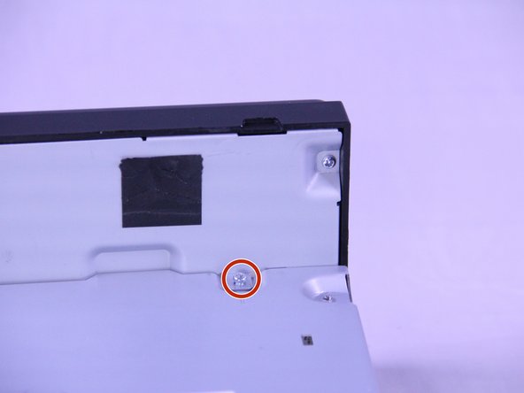

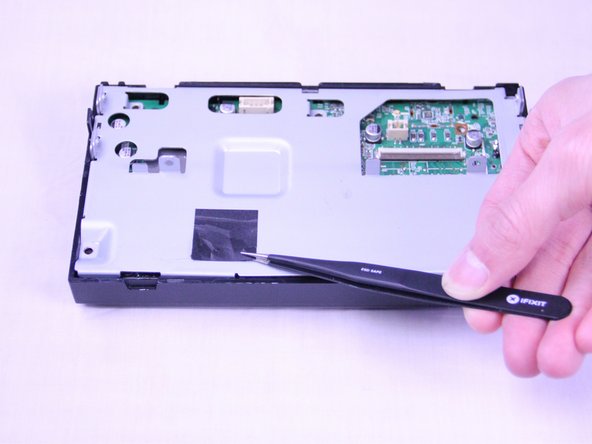

  10. Sony XAV-AX100 Display Board Replacement, Display Board: crwdns2935265:010crwdnd2935265:01crwdnd2935265:03crwdne2935265:0 Sony XAV-AX100 Display Board Replacement, Display Board: crwdns2935265:010crwdnd2935265:02crwdnd2935265:03crwdne2935265:0 Sony XAV-AX100 Display Board Replacement, Display Board: crwdns2935265:010crwdnd2935265:03crwdnd2935265:03crwdne2935265:0
    • Remove the four 3.5mm Phillips #0 screws from the display board.
    • Remove the black tape using a precise tweezer.
    • Remove the 3.5mm Phillips #0 screw from underneath the tape.

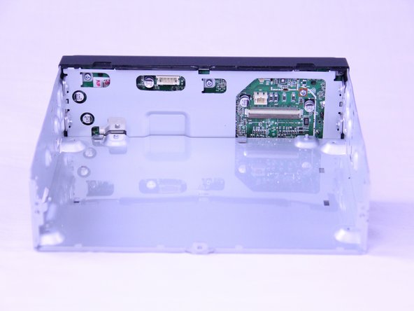

  11. Sony XAV-AX100 Display Board Replacement: crwdns2935265:011crwdnd2935265:01crwdnd2935265:01crwdne2935265:0
    • Remove the two 2mm Phillips #0 screws from the back plate.
    • Remove the back plate.

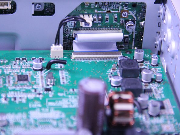

  12. Sony XAV-AX100 Display Board Replacement: crwdns2935265:012crwdnd2935265:01crwdnd2935265:01crwdne2935265:0
    • Remove the single 2mm Phillips #0 screw from the motherboard.
    • Use a spudger to flip up the retaining flap on the display ribbon cable ZIF socket.
  13. Sony XAV-AX100 Display Board Replacement: crwdns2935265:013crwdnd2935265:01crwdnd2935265:01crwdne2935265:0
    • Use a plastic opening tool to remove the display board from the radio.
