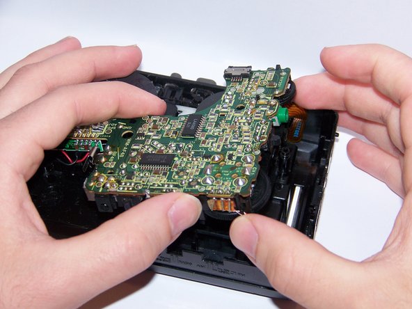

  3. Sony Walkman WM-AF48 Headphone Jack Replacement, Remove the motherboard: crwdns2935265:03crwdnd2935265:01crwdnd2935265:02crwdne2935265:0 Sony Walkman WM-AF48 Headphone Jack Replacement, Remove the motherboard: crwdns2935265:03crwdnd2935265:02crwdnd2935265:02crwdne2935265:0
    • Gently pull the ribbon from the jack just above the film revolver, near the edge.
    • Carefully lift the motherboard out of the outer shell.
    • Be careful to only handle the motherboard by the edges. Avoid touching the metal parts.
  4. Sony Walkman WM-AF48 Headphone Jack Replacement, Remove the headphone jack: crwdns2935265:04crwdnd2935265:01crwdnd2935265:01crwdne2935265:0
    • Locate the four metal points on the motherboard that hold the headphone jack in place.
    • Using a soldering iron, remove the headphone jack by de-soldering the four points that hold it in place.
