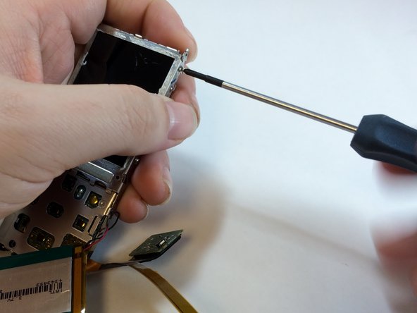

    • Remove the two 1.8 mm Phillips screws from both sides of the frame.
  23. Sony Walkman NWZ-S764 LCD Screen Replacement: crwdns2935265:023crwdnd2935265:01crwdnd2935265:03crwdne2935265:0 Sony Walkman NWZ-S764 LCD Screen Replacement: crwdns2935265:023crwdnd2935265:02crwdnd2935265:03crwdne2935265:0 Sony Walkman NWZ-S764 LCD Screen Replacement: crwdns2935265:023crwdnd2935265:03crwdnd2935265:03crwdne2935265:0
    • Use a strong pry tool to lift the metal brackets away from the device. You will need to bend the metal slightly to remove it from the dimples.
    • This step will require slight force to separate the frame. Do not bend the brackets too far so that they can be replaced later.
    • Once separated, pull the innermost frame containing the LCD display away from the brackets.
