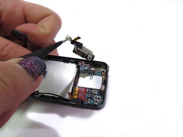

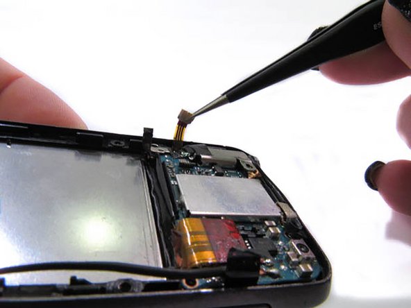

    • Using the fine pointed tweezers, unplug the cords connecting the headphone jack to the chip.

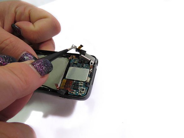

  5. Sony Walkman NWZ-E438 Headphone Jack Replacement: crwdns2935265:05crwdnd2935265:01crwdnd2935265:03crwdne2935265:0 Sony Walkman NWZ-E438 Headphone Jack Replacement: crwdns2935265:05crwdnd2935265:02crwdnd2935265:03crwdne2935265:0 Sony Walkman NWZ-E438 Headphone Jack Replacement: crwdns2935265:05crwdnd2935265:03crwdnd2935265:03crwdne2935265:0
    • Remove the headphone jack.
