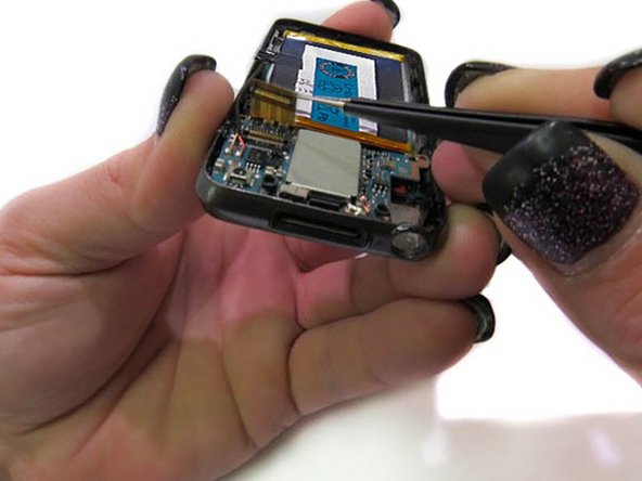

  5. Sony Walkman NWZ-E438 Battery Replacement: crwdns2935265:05crwdnd2935265:01crwdnd2935265:01crwdne2935265:0
    • Remove the yellow film covering the circuit board with pointed precision tweezers.
  6. Sony Walkman NWZ-E438 Battery Replacement: crwdns2935265:06crwdnd2935265:01crwdnd2935265:02crwdne2935265:0 Sony Walkman NWZ-E438 Battery Replacement: crwdns2935265:06crwdnd2935265:02crwdnd2935265:02crwdne2935265:0
    • Using tweezers, unplug the gold band connecting the device and circuit board.
  7. Sony Walkman NWZ-E438 Battery Replacement: crwdns2935265:07crwdnd2935265:01crwdnd2935265:02crwdne2935265:0 Sony Walkman NWZ-E438 Battery Replacement: crwdns2935265:07crwdnd2935265:02crwdnd2935265:02crwdne2935265:0
    • Using pointed precision tweezers, unplug the wires connecting the battery and chip from the chip.
  8. Sony Walkman NWZ-E438 Battery Replacement: crwdns2935265:08crwdnd2935265:01crwdnd2935265:01crwdne2935265:0
    • Remove battery.
