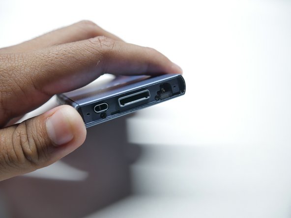

    • Turn on your Walkman and allow the battery to discharge below 5% before starting any repairs, as a charged Lithium Battery can be dangerous if accidentally punctured.
    • Turn off the device.

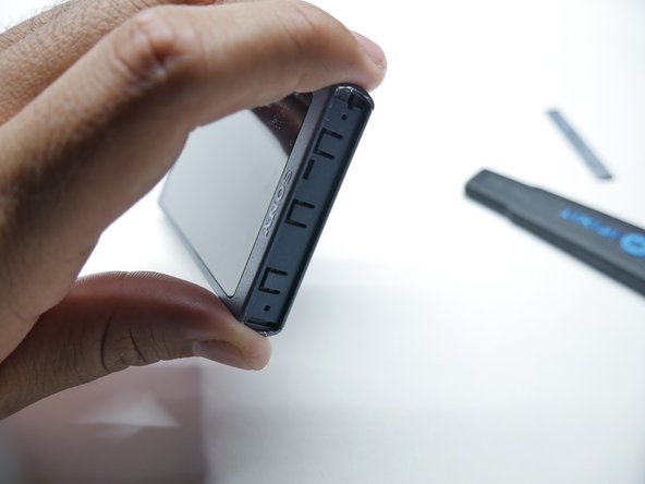

  2. Sony Walkman A-45 Battery Replacement: crwdns2935265:02crwdnd2935265:01crwdnd2935265:03crwdne2935265:0 Sony Walkman A-45 Battery Replacement: crwdns2935265:02crwdnd2935265:02crwdnd2935265:03crwdne2935265:0 Sony Walkman A-45 Battery Replacement: crwdns2935265:02crwdnd2935265:03crwdnd2935265:03crwdne2935265:0

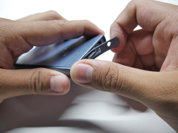

    • Insert a Jimmy into the thin gap between the shell and the side of the top cover, along the edge of one of the panels.
    • Pry up on the top cover to release it from the adhesive.
    • Once the adhesive doesn't stick from one edge, the rest disconnects easily. It will take a couple tries.

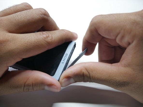

  3. Sony Walkman A-45 Battery Replacement: crwdns2935265:03crwdnd2935265:01crwdnd2935265:03crwdne2935265:0 Sony Walkman A-45 Battery Replacement: crwdns2935265:03crwdnd2935265:02crwdnd2935265:03crwdne2935265:0 Sony Walkman A-45 Battery Replacement: crwdns2935265:03crwdnd2935265:03crwdnd2935265:03crwdne2935265:0

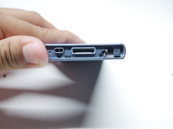

    • Insert a Jimmy into the thin gap between the shell and the side of the bottom cover, along the edge of one of the panels.
    • Pry up on the bottom cover to release it from the adhesive.

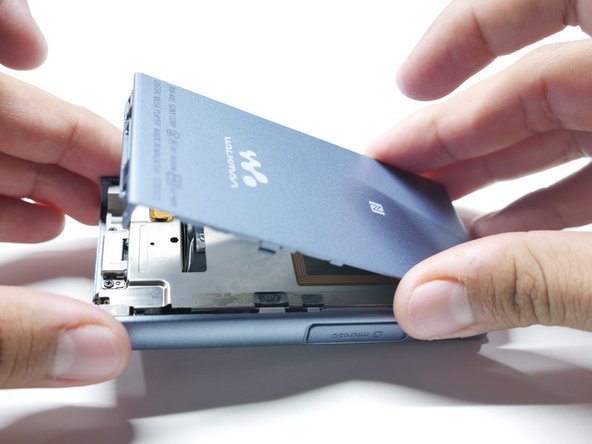

    • Flip the walkman on its screen.
    • Insert a Jimmy into the thin gap between the side panel and shell, along the edge of the panel.
    • Slowly pry up the back cover to release it from its adhesive.
    • If you have difficulty keeping the gap up, insert opening picks to prop it open.

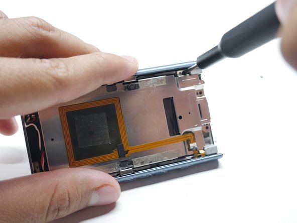

  6. Sony Walkman A-45 Battery Replacement: crwdns2935265:06crwdnd2935265:01crwdnd2935265:03crwdne2935265:0 Sony Walkman A-45 Battery Replacement: crwdns2935265:06crwdnd2935265:02crwdnd2935265:03crwdne2935265:0 Sony Walkman A-45 Battery Replacement: crwdns2935265:06crwdnd2935265:03crwdnd2935265:03crwdne2935265:0

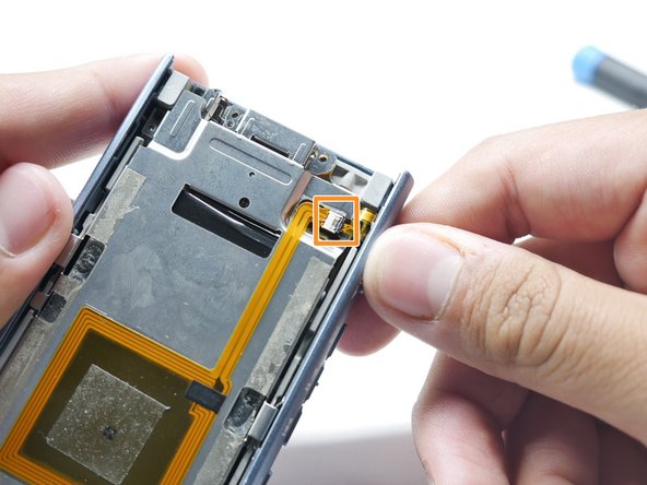

    • Remove the five screws holding down the battery and NFC Module using a Phillips #00 screwdriver.
    • Detach the ribbon cable connecting the NFC Module by pulling outward.
    • Don't pull too hard or else the ribbon cable will rip.

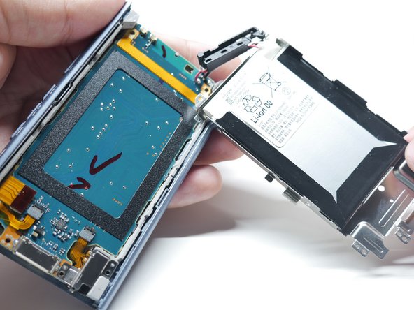

  7. Sony Walkman A-45 Battery Replacement, Remove the Battery: crwdns2935265:07crwdnd2935265:01crwdnd2935265:03crwdne2935265:0 Sony Walkman A-45 Battery Replacement, Remove the Battery: crwdns2935265:07crwdnd2935265:02crwdnd2935265:03crwdne2935265:0 Sony Walkman A-45 Battery Replacement, Remove the Battery: crwdns2935265:07crwdnd2935265:03crwdnd2935265:03crwdne2935265:0

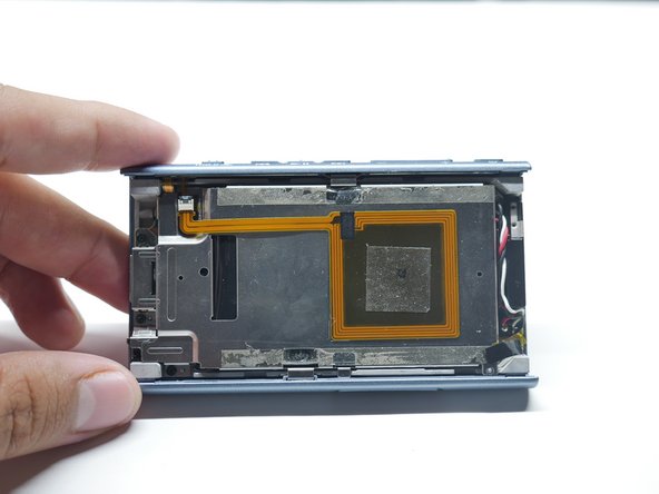

    • Lift up the metal chassis carefully.
    • There will be a block piece which holds the wires. Pull it up carefully and it should come off.

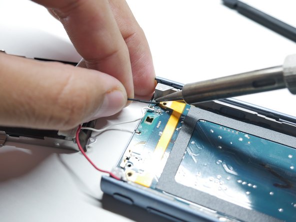

  8. Sony Walkman A-45 Battery Replacement: crwdns2935265:08crwdnd2935265:01crwdnd2935265:03crwdne2935265:0 Sony Walkman A-45 Battery Replacement: crwdns2935265:08crwdnd2935265:02crwdnd2935265:03crwdne2935265:0 Sony Walkman A-45 Battery Replacement: crwdns2935265:08crwdnd2935265:03crwdnd2935265:03crwdne2935265:0

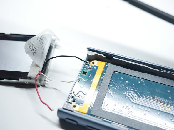

    • Heat a soldering iron to 420 degrees Celsius.
    • Heat up the old solder in the Walkman and remove the wire from its terminal.
    • This process will take time to remove the wires.

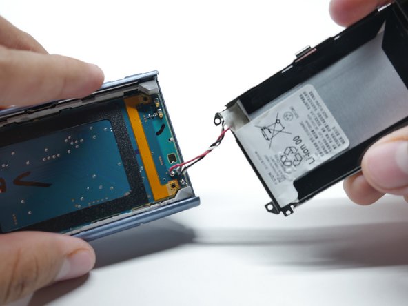

  9. Sony Walkman A-45 Battery Replacement: crwdns2935265:09crwdnd2935265:01crwdnd2935265:01crwdne2935265:0
    • Loosen the battery adhesive by using isopropyl alcohol.
    • Use Isopropyl Alcohol 90% or greater.
    • Pry out the battery using plastic cards.
    • Make sure to NOT bend the battery, Take your time during this process.
    • Remove the battery.
