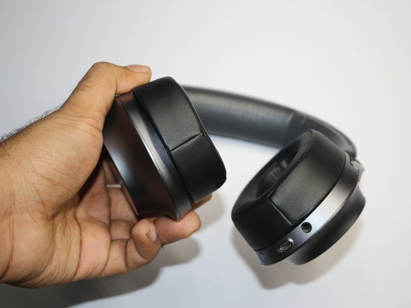

    • Place the edge opening tool between the headphones and earpad cushion, gently pry upward to release the clips securing the earpads.
    • Use the prying tool at different angles around the earpad.
    • Avoid using too much force when prying.

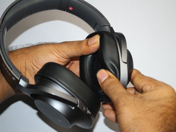

    • Remove the earpad.

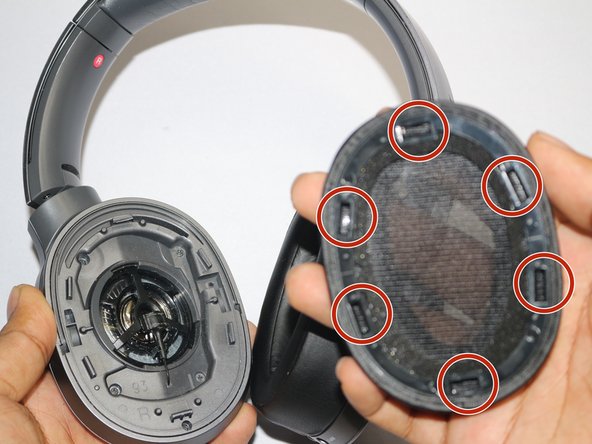

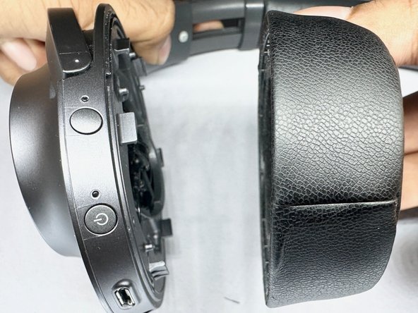

    • Line up the back of the new earpad cushion with the six hooks on the inside of the headphone cup.
  4. Sony WH-H900n Earpad Cushion Replacement: crwdns2935265:04crwdnd2935265:01crwdnd2935265:03crwdne2935265:0 Sony WH-H900n Earpad Cushion Replacement: crwdns2935265:04crwdnd2935265:02crwdnd2935265:03crwdne2935265:0 Sony WH-H900n Earpad Cushion Replacement: crwdns2935265:04crwdnd2935265:03crwdnd2935265:03crwdne2935265:0

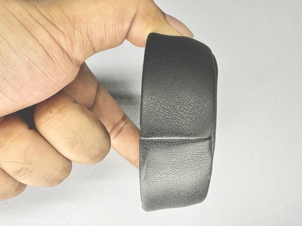

    • Make sure the seam of the earpad is facing the bottom.

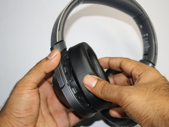

    • Align the back of the earpad with the inside of the headphone cup.
    • Slide the earpad cushion onto the hooks in the ear cup.
  6. Sony WH-H900n Earpad Cushion Replacement: crwdns2935265:06crwdnd2935265:01crwdnd2935265:02crwdne2935265:0 Sony WH-H900n Earpad Cushion Replacement: crwdns2935265:06crwdnd2935265:02crwdnd2935265:02crwdne2935265:0
    • Hold the earpad cushion securely and press down until you hear a "click".
