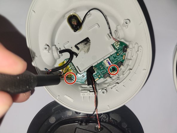

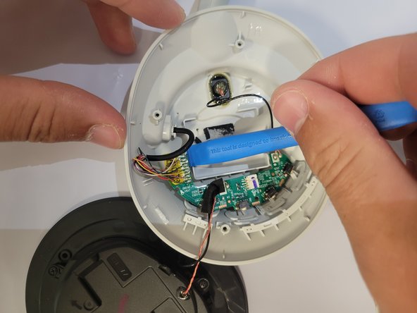

  4. Sony WH-CH720N Volume & Noise Cancelling Control Button Replacement, Volume & Noise Cancelling Control Button: crwdns2935265:04crwdnd2935265:01crwdnd2935265:03crwdne2935265:0 Sony WH-CH720N Volume & Noise Cancelling Control Button Replacement, Volume & Noise Cancelling Control Button: crwdns2935265:04crwdnd2935265:02crwdnd2935265:03crwdne2935265:0 Sony WH-CH720N Volume & Noise Cancelling Control Button Replacement, Volume & Noise Cancelling Control Button: crwdns2935265:04crwdnd2935265:03crwdnd2935265:03crwdne2935265:0
    • Unscrew the two 3 mm screws retaining the circuit board to the headphones.
    • Carefully remove the circuit board with the plastic prying tool.

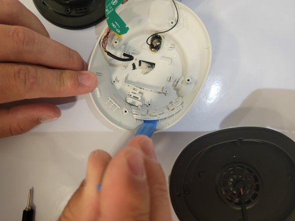

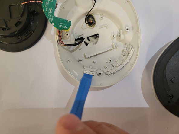

  5. Sony WH-CH720N Volume & Noise Cancelling Control Button Replacement: crwdns2935265:05crwdnd2935265:01crwdnd2935265:03crwdne2935265:0 Sony WH-CH720N Volume & Noise Cancelling Control Button Replacement: crwdns2935265:05crwdnd2935265:02crwdnd2935265:03crwdne2935265:0 Sony WH-CH720N Volume & Noise Cancelling Control Button Replacement: crwdns2935265:05crwdnd2935265:03crwdnd2935265:03crwdne2935265:0
    • Next, use the prying tool to remove the buttons.
  6. Sony WH-CH720N Volume & Noise Cancelling Control Button Replacement: crwdns2935265:06crwdnd2935265:01crwdnd2935265:01crwdne2935265:0
    • Remove buttons and replace.
