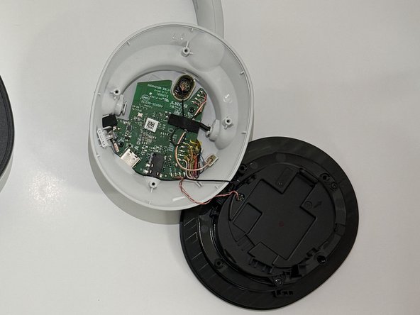

    • Place the headphones down on a table, and orient them in this way.
  2. Sony WH-CH720N Charging Port Replacement: crwdns2935265:02crwdnd2935265:01crwdnd2935265:03crwdne2935265:0 Sony WH-CH720N Charging Port Replacement: crwdns2935265:02crwdnd2935265:02crwdnd2935265:03crwdne2935265:0 Sony WH-CH720N Charging Port Replacement: crwdns2935265:02crwdnd2935265:03crwdnd2935265:03crwdne2935265:0
    • Remove the earmuff.
    • Check introductions to ensure you remove the correct side earmuff for each repair guide!
  3. Sony WH-CH720N Charging Port Replacement, Charging Port: crwdns2935265:03crwdnd2935265:01crwdnd2935265:02crwdne2935265:0 Sony WH-CH720N Charging Port Replacement, Charging Port: crwdns2935265:03crwdnd2935265:02crwdnd2935265:02crwdne2935265:0
    • Use a Philips #00 screwdriver to remove the four 5 mm screws from the left driver housing.

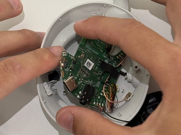

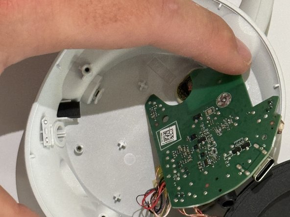

    • Using the same bit, remove the two 3 mm screws from the circuit board.
    • Gently remove the circuit board.
  5. Sony WH-CH720N Charging Port Replacement: crwdns2935265:05crwdnd2935265:01crwdnd2935265:01crwdne2935265:0
    • Desolder the four joints holding the USB-C charging port there.
    • Pull the charging port off.
    • Solder the new charging port onto the board.
