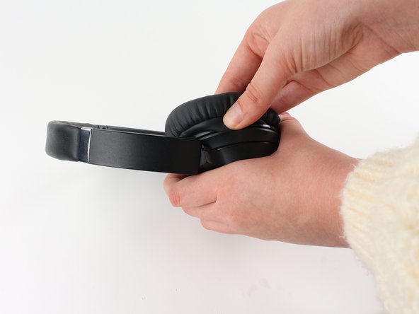

    • Identify the free edge of the ear pad.
  2. Sony WH-CH700N Headphone Pad Cover Replacement: crwdns2935265:02crwdnd2935265:01crwdnd2935265:03crwdne2935265:0 Sony WH-CH700N Headphone Pad Cover Replacement: crwdns2935265:02crwdnd2935265:02crwdnd2935265:03crwdne2935265:0 Sony WH-CH700N Headphone Pad Cover Replacement: crwdns2935265:02crwdnd2935265:03crwdnd2935265:03crwdne2935265:0
    • Gently pull the free edge up.
    • Slight pressure is needed, but there is no glue.
    • Fully remove the ear pad.
    • If yours are more deteriorated, make sure to remove all excess material.
