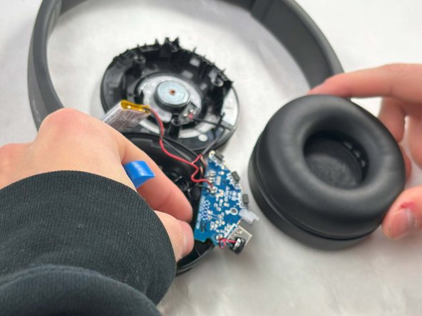

    • Hold the headphones in one hand, and with your other hand lightly pinch the earpad cushion.
  2. Sony WH-CH520 USB-C Charging Port Replacement: crwdns2935265:02crwdnd2935265:01crwdnd2935265:03crwdne2935265:0 Sony WH-CH520 USB-C Charging Port Replacement: crwdns2935265:02crwdnd2935265:02crwdnd2935265:03crwdne2935265:0 Sony WH-CH520 USB-C Charging Port Replacement: crwdns2935265:02crwdnd2935265:03crwdnd2935265:03crwdne2935265:0
    • Pull the pinched portion of the cushion up and towards yourself.
    • Pull part of the cushion off of the lip of the headphones.
    • Fully remove by pulling the earpad cushion down and away from yourself.

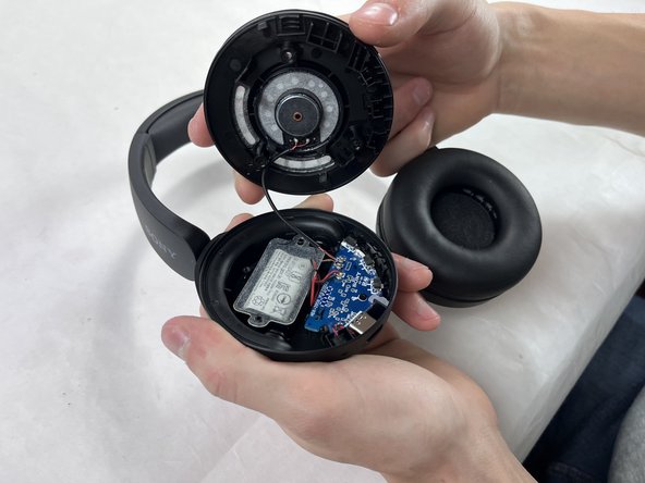

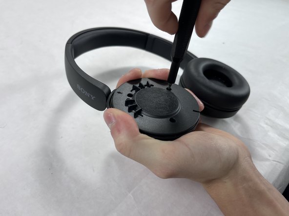

    • Remove the three 2.5 mm screws from the right side of the headphones using a JIS #00 screwdriver.

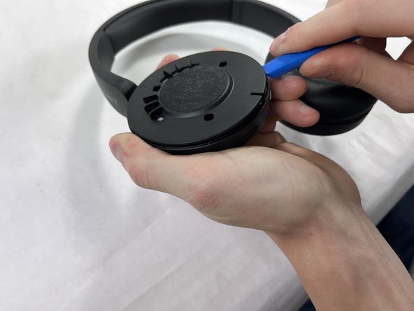

    • Place one end of an opening tool against the edge of the base with the hook-like side pushing up against the covering.
    • Carefully pull the tool down against the edge to lift the covering.
    • Move the tool to different spots around the base of the headphones to pry it up until the covering comes off.

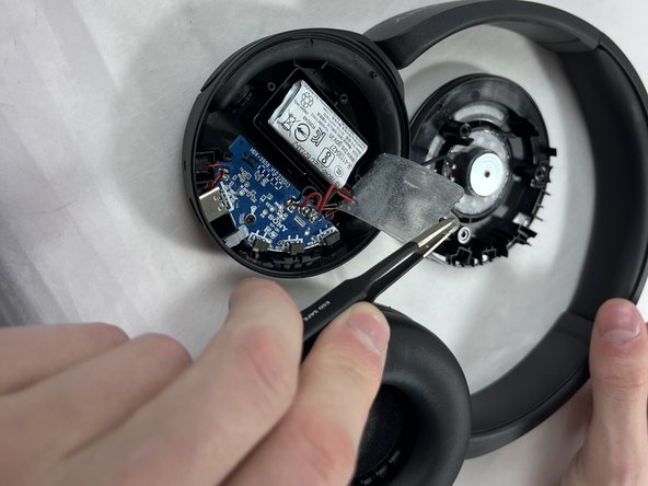

    • Carefully remove the film adhesive on top of the battery using a pair of tweezers.

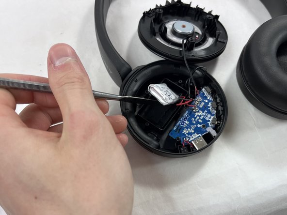

    • Carefully pry the battery up and off of its adhesive using a spudger.
    • You can rest the battery in its well to prevent it from getting in the way later

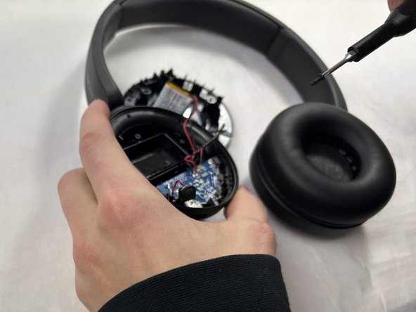

    • Remove the 2.5 mm screw from the center of the motherboard using a Phillips #00 screwdriver.

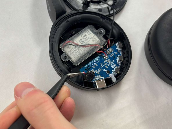

    • Use the tweezers to pinch the silicone casing surrounding the microphone.
    • Pull it up and out from the headphone casing.

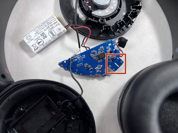

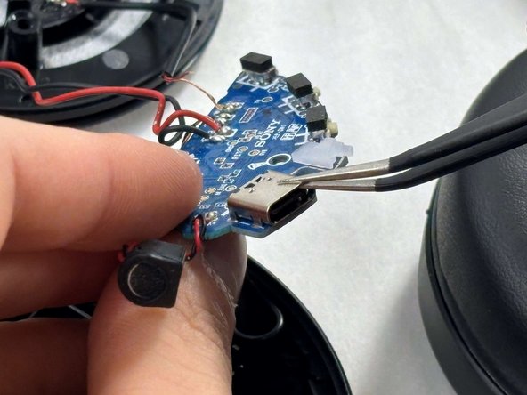

    • Use the opening tool to lift the motherboard out of the headphone casing.
    • Isolate all wires and electronic components from the plastic pieces.
    • Flip the motherboard such that the back pins of the charging port are exposed.
  10. Sony WH-CH520 USB-C Charging Port Replacement: crwdns2935265:010crwdnd2935265:01crwdnd2935265:02crwdne2935265:0 Sony WH-CH520 USB-C Charging Port Replacement: crwdns2935265:010crwdnd2935265:02crwdnd2935265:02crwdne2935265:0
    • Heat your soldering iron to around 350-450°F (175°C-230°C).
    • Reheat the solder on each pin one by one.
    • After reheating, use the tweezers to pull up on the charging port, releasing each pin from its place.
    • The soldering iron and metal components will be HOT; use caution when handling.
