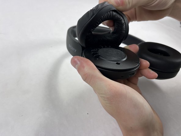

    • Lay headphones flat against the surface with the ear cushions oriented upwards.
    • Pinch the cushion near the edge of the device to carefully pull the cushion off.

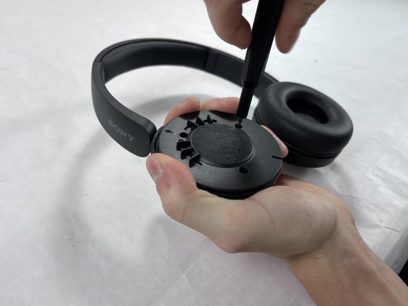

    • Remove the three 2.5 mm screws from the headphones using a JIS #00 screwdriver.

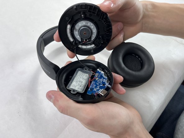

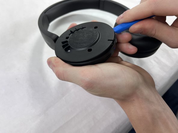

    • Place one end of an opening tool against the edge of the base with the hook-like side pushing up against the covering.
    • Carefully pull the tool down against the edge to lift the covering.
    • Move the tool to different spots around the base of the headphones to pry it up until the covering comes off.

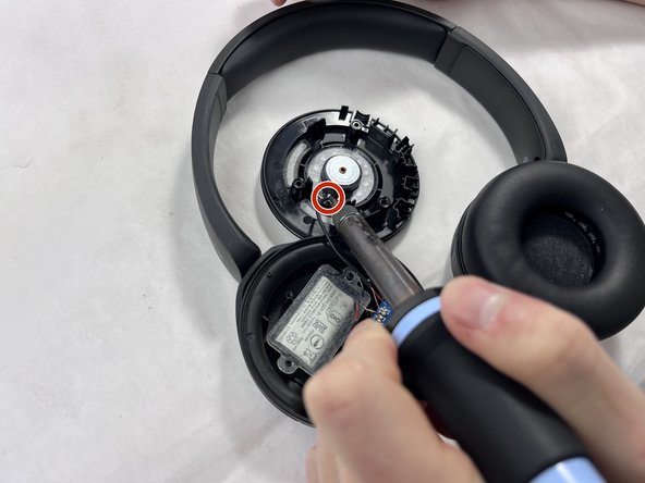

    • Use a soldering iron to desolder the two connections where the exposed wires meet the speaker contact.
    • Pull the wire away from the speaker to remove it while the solder melts. Do this for both wires.
    • Disconnect the wires from the speaker driver, and you will be able to replace the old driver with the new one using the same wires.
