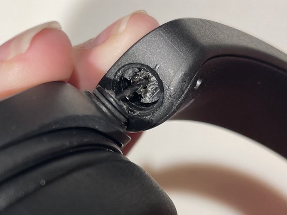

Sony WH-CH520 Severed Wire Repair
  1. Sony WH-CH520 Severed Wire Repair, Sony WH-CH520 Severed Wire Repair: crwdns2935265:01crwdnd2935265:01crwdnd2935265:01crwdne2935265:0
    • Plug in the soldering iron, allowing it time to heat to 480 degrees Fahrenheit.
  2. Sony WH-CH520 Severed Wire Repair: crwdns2935265:02crwdnd2935265:01crwdnd2935265:02crwdne2935265:0 Sony WH-CH520 Severed Wire Repair: crwdns2935265:02crwdnd2935265:02crwdnd2935265:02crwdne2935265:0
    • Gently feed the wire back into the headband piece of the headset.
  3. Sony WH-CH520 Severed Wire Repair: crwdns2935265:03crwdnd2935265:01crwdnd2935265:01crwdne2935265:0
    • Seat the headphone back into the headset, making sure to keep it angled in the desired direction.
  4. Sony WH-CH520 Severed Wire Repair: crwdns2935265:04crwdnd2935265:01crwdnd2935265:01crwdne2935265:0
    • Apply the soldering tip around the circumference where the headphone and headset meet, allowing the tip to rest for about one second in each area it touches.
    • Soldering involves using a high degree of heat. Avoid touching the soldering tip or the melted materials as they cool.
  5. Sony WH-CH520 Severed Wire Repair: crwdns2935265:05crwdnd2935265:01crwdnd2935265:01crwdne2935265:0
    • Apply steady pressure to the headset while the heat soaks in and the plastic cools. This should take about 2 minutes.
