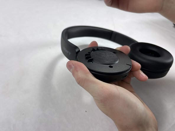

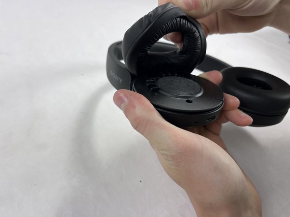

    • Hold the headphones in one hand, and with your other hand lightly pinch the earpad cushion.
  2. Sony WH-CH520 Microphone Replacement: crwdns2935265:02crwdnd2935265:01crwdnd2935265:03crwdne2935265:0 Sony WH-CH520 Microphone Replacement: crwdns2935265:02crwdnd2935265:02crwdnd2935265:03crwdne2935265:0 Sony WH-CH520 Microphone Replacement: crwdns2935265:02crwdnd2935265:03crwdnd2935265:03crwdne2935265:0
    • Pull the pinched portion of the cushion up and towards yourself.
    • Pull part of the cushion off of the lip of the headphones.
    • Fully remove by pulling the earpad cushion down and away from yourself.

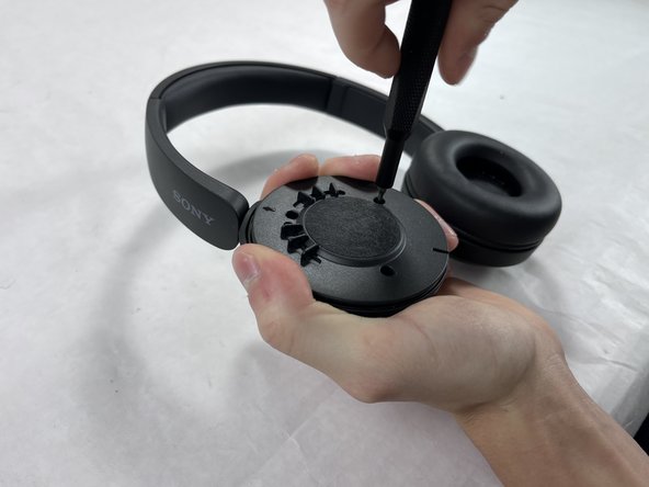

    • Remove the three 2.5 mm screws from the headphones using a JIS #00 screwdriver.

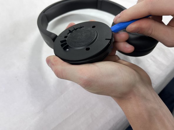

    • Place one end of an opening tool against the edge of the base with the hook-like side pushing up against the covering.
    • Carefully pull the tool down against the edge to lift the covering.
    • Move the tool to different spots around the base of the headphones to pry it up until the covering comes off.

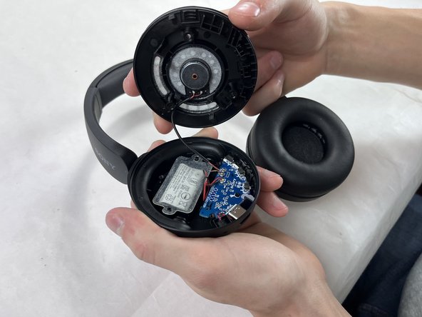

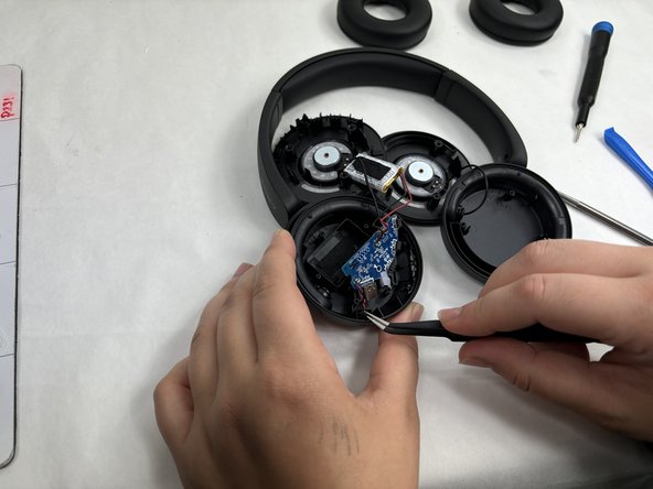

  5. Sony WH-CH520 Microphone Replacement: crwdns2935265:05crwdnd2935265:01crwdnd2935265:01crwdne2935265:0
    • There are two wires (one red and one black) connected to the B+ and the B- terminals on the motherboard.
    • Desolder the wire attached to the B- terminal first.

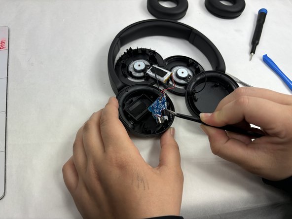

  6. Sony WH-CH520 Microphone Replacement: crwdns2935265:06crwdnd2935265:01crwdnd2935265:03crwdne2935265:0 Sony WH-CH520 Microphone Replacement: crwdns2935265:06crwdnd2935265:02crwdnd2935265:03crwdne2935265:0 Sony WH-CH520 Microphone Replacement: crwdns2935265:06crwdnd2935265:03crwdnd2935265:03crwdne2935265:0
    • The wires will be attached to the M+ and M- terminals on the motherboard.
    • Desolder the wire attached to the M- terminal first.
    • Desolder the wires attached to the microphone from the motherboard.
    • Remove the microphone using tweezers.
