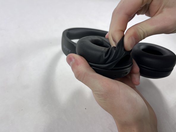

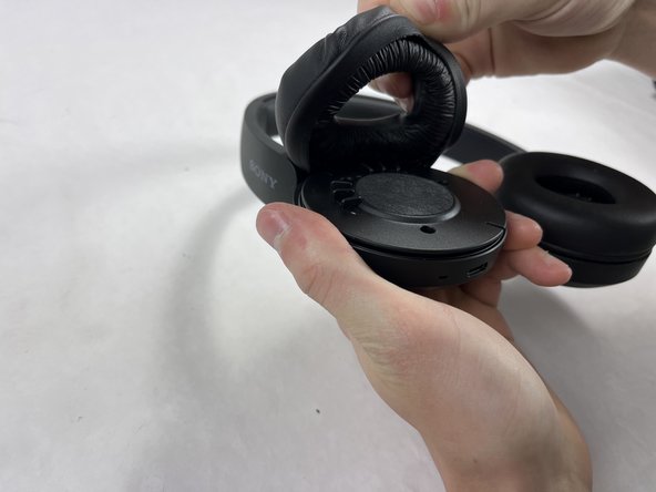

    • Lay headphones flat against the surface with the ear cushions oriented upwards.
    • Pinch the cushion of the right labeled headphone near the edge of the device to carefully pull the cushion off.

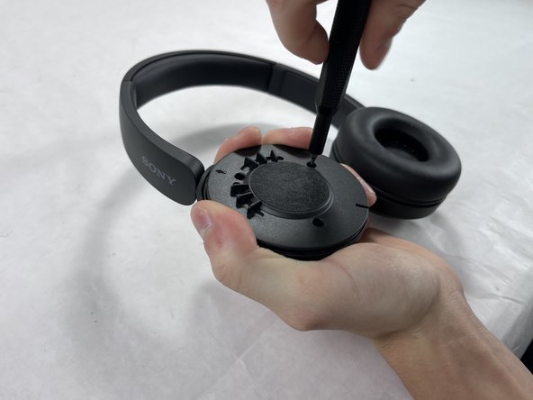

  2. Sony WH-CH520 Battery Replacement: crwdns2935265:02crwdnd2935265:01crwdnd2935265:02crwdne2935265:0 Sony WH-CH520 Battery Replacement: crwdns2935265:02crwdnd2935265:02crwdnd2935265:02crwdne2935265:0
    • Remove the three 2.5 mm screws from the headphones using a JIS #00 screwdriver.

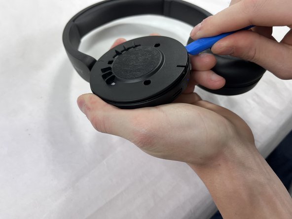

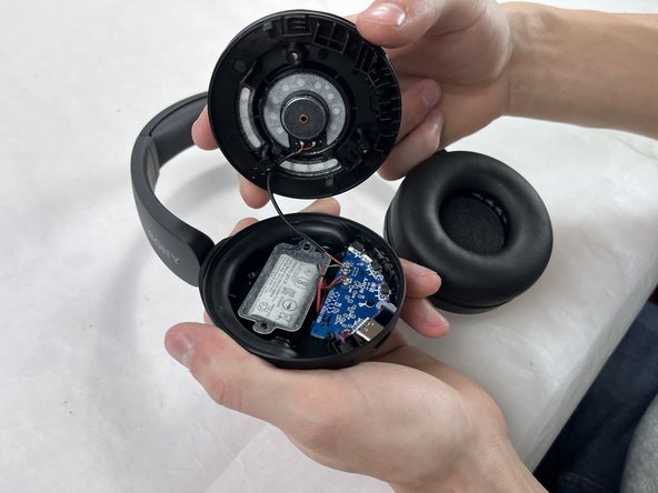

  3. Sony WH-CH520 Battery Replacement: crwdns2935265:03crwdnd2935265:01crwdnd2935265:03crwdne2935265:0 Sony WH-CH520 Battery Replacement: crwdns2935265:03crwdnd2935265:02crwdnd2935265:03crwdne2935265:0 Sony WH-CH520 Battery Replacement: crwdns2935265:03crwdnd2935265:03crwdnd2935265:03crwdne2935265:0
    • Place one end of an opening tool against the edge of the base with the hook-like side pushing up against the covering.
    • Carefully pull the tool down against the edge to lift the covering.
    • Move the tool to different spots around the base of the headphones to pry it up until the covering comes off.

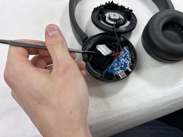

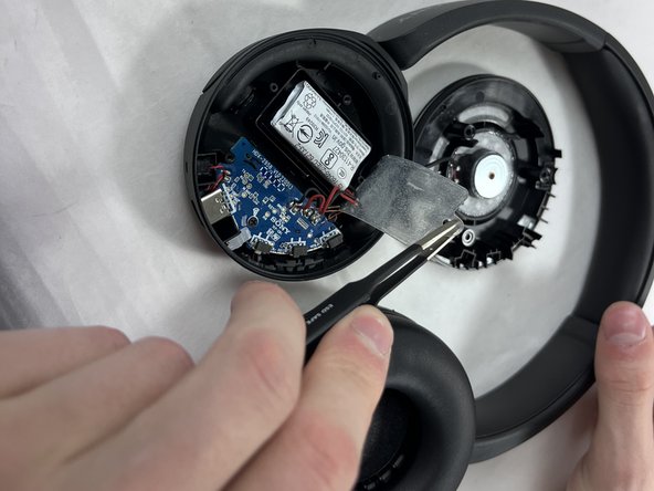

  4. Sony WH-CH520 Battery Replacement: crwdns2935265:04crwdnd2935265:01crwdnd2935265:02crwdne2935265:0 Sony WH-CH520 Battery Replacement: crwdns2935265:04crwdnd2935265:02crwdnd2935265:02crwdne2935265:0
    • Carefully remove the film adhesive on top of the battery using a pair of tweezers.

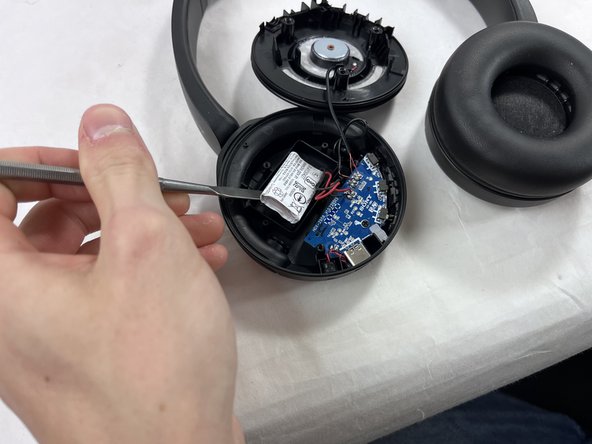

  5. Sony WH-CH520 Battery Replacement: crwdns2935265:05crwdnd2935265:01crwdnd2935265:03crwdne2935265:0 Sony WH-CH520 Battery Replacement: crwdns2935265:05crwdnd2935265:02crwdnd2935265:03crwdne2935265:0 Sony WH-CH520 Battery Replacement: crwdns2935265:05crwdnd2935265:03crwdnd2935265:03crwdne2935265:0
    • Carefully pry the battery up and off of its adhesive using a spudger.
    • You can rest the battery in its well to prevent it from getting in the way later

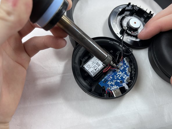

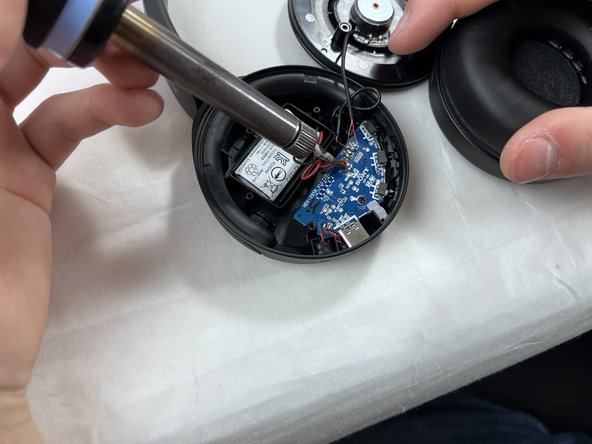

  6. Sony WH-CH520 Battery Replacement: crwdns2935265:06crwdnd2935265:01crwdnd2935265:03crwdne2935265:0 Sony WH-CH520 Battery Replacement: crwdns2935265:06crwdnd2935265:02crwdnd2935265:03crwdne2935265:0 Sony WH-CH520 Battery Replacement: crwdns2935265:06crwdnd2935265:03crwdnd2935265:03crwdne2935265:0
    • Find the wires connecting the motherboard to the battery.
    • Remember which wires are positive and negative.
    • Using a soldering iron, carefully desolder the red and black wires from the motherboard and replace with the new battery and wires.
