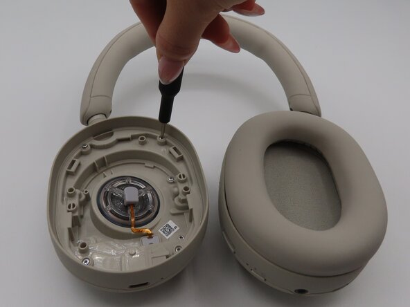

    • Place the edge of an iFixit opening tool under the earpad cushion.
    • Slide it alongside the edge of the cushion until it detaches from the rest of the headphones.
  2. Sony WH-1000XM5 Touch Sensor Replacement, Touch Sensor: crwdns2935265:02crwdnd2935265:01crwdnd2935265:02crwdne2935265:0 Sony WH-1000XM5 Touch Sensor Replacement, Touch Sensor: crwdns2935265:02crwdnd2935265:02crwdnd2935265:02crwdne2935265:0
    • Remove the eight 2.4mm screws located inside the right ear cup using a Phillips #000 screwdriver.

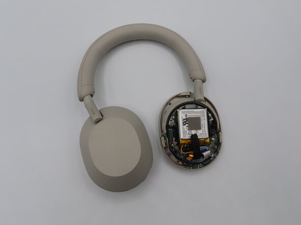

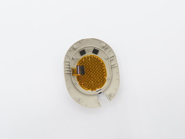

    • Flip the headphones over.
    • Carefully lift the plastic cover slightly, but do not remove it completely.
    • The touch sensor has a ribbon cable connected to the mainboard.
    • Gently grab the ribbon cable and pull away from the connector to disconnect it.
    • Do not attempt to remove the touch sensor; it is glued to the plastic ear cup cover.
