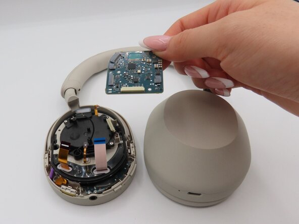

  2. Sony WH-1000XM5 Motherboard Replacement, Motherboard: crwdns2935265:02crwdnd2935265:01crwdnd2935265:02crwdne2935265:0 Sony WH-1000XM5 Motherboard Replacement, Motherboard: crwdns2935265:02crwdnd2935265:02crwdnd2935265:02crwdne2935265:0
    • Use a Phillips #000 screwdriver to remove the eight 2.4 mm screws along the outer inside edge of the left earcup.
    • The shell of the earcup will be loose.
    • Flip over the headphones and remove the shell of the earcup.

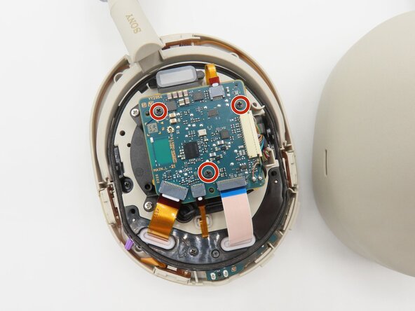

  3. Sony WH-1000XM5 Motherboard Replacement: crwdns2935265:03crwdnd2935265:01crwdnd2935265:03crwdne2935265:0 Sony WH-1000XM5 Motherboard Replacement: crwdns2935265:03crwdnd2935265:02crwdnd2935265:03crwdne2935265:0 Sony WH-1000XM5 Motherboard Replacement: crwdns2935265:03crwdnd2935265:03crwdnd2935265:03crwdne2935265:0
    • Using your index finger and thumb, gently pull out the five ribbons attached to the motherboard.
    • Use a Phillips #000 screwdriver to remove the three 1.4 mm screws from the motherboard.
    • At this point there should only be two wires attached to the motherboard.
  4. Sony WH-1000XM5 Motherboard Replacement: crwdns2935265:04crwdnd2935265:01crwdnd2935265:02crwdne2935265:0 Sony WH-1000XM5 Motherboard Replacement: crwdns2935265:04crwdnd2935265:02crwdnd2935265:02crwdne2935265:0
    • Caution: Please wear safety glasses and take caution when handling a hot soldering iron. Without the proper safety precautions, soldering can cause burns, fires, and lingering health effects.
    • Using the souldering iron, carefully desolder the two wires that still remain on the motherboard.
    • Remove the motherboard.
