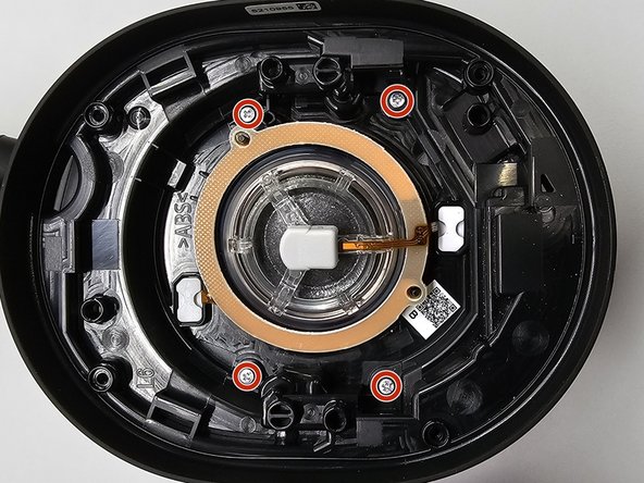

  3. Sony WH-1000XM5 3.5mm Jack Replacement / Debris Removal, Removing Earcup Screws: crwdns2935265:03crwdnd2935265:01crwdnd2935265:03crwdne2935265:0 Sony WH-1000XM5 3.5mm Jack Replacement / Debris Removal, Removing Earcup Screws: crwdns2935265:03crwdnd2935265:02crwdnd2935265:03crwdne2935265:0 Sony WH-1000XM5 3.5mm Jack Replacement / Debris Removal, Removing Earcup Screws: crwdns2935265:03crwdnd2935265:03crwdnd2935265:03crwdne2935265:0
    Phillips #000 Screwdriver
    $5.49

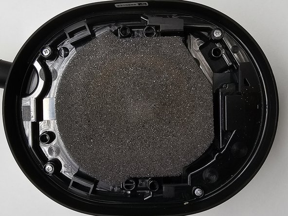

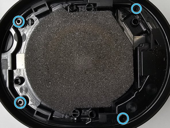

    • Using a Phillips #000 screwdriver, remove all 4 of these screws.
    • Removing the piece of foam in the middle of the earcup will reveal the main driver, as well as 4 more screws.
    • Using a Phillips #000 screwdriver, remove the last four screws within the interior of the earcup.

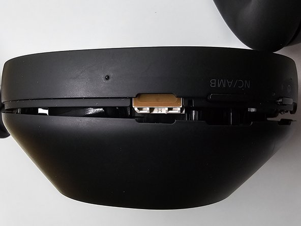

  4. Sony WH-1000XM5 3.5mm Jack Replacement / Debris Removal, Removing the Earcup Shell: crwdns2935265:04crwdnd2935265:01crwdnd2935265:02crwdne2935265:0 Sony WH-1000XM5 3.5mm Jack Replacement / Debris Removal, Removing the Earcup Shell: crwdns2935265:04crwdnd2935265:02crwdnd2935265:02crwdne2935265:0
    • With all 8 screws removed, the shell of the earcup will be loose.
    • Carefully remove the shell of the earcup. There are no adhesives or screws left holding the assembly together, so no force should be necessary.
    • If the shell does not immediately feel lose, Stop. Go back and ensure all 8 screws have been removed.

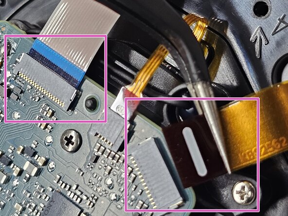

    • With the shell removed, you can now access the majority of the components housed within the left earcup.
    • Locate the small screw located between the two ribbon cables. It is marked "L4" and identifiable by the arrow pointing directly at it. Using a Phillips #000 screwdriver, remove this screw.
    • Carefully disconnect both ribbon cables from the top-most circuit board.
    • Be careful not to bend or puncture either of these cables.

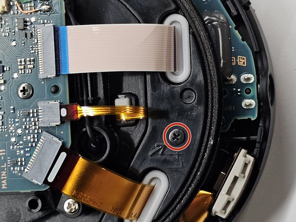

  6. Sony WH-1000XM5 3.5mm Jack Replacement / Debris Removal, Lifting the "L4" Frame: crwdns2935265:06crwdnd2935265:01crwdnd2935265:02crwdne2935265:0 Sony WH-1000XM5 3.5mm Jack Replacement / Debris Removal, Lifting the "L4" Frame: crwdns2935265:06crwdnd2935265:02crwdnd2935265:02crwdne2935265:0
    • With the "L4" screw removed and the ribbon cables disconnected, you can safely pull up the small plastic frame with the two white gaskets.
    • You can fully remove the ribbon cables from their gaskets, but it is not necessary for accessing the 3.5mm jack.

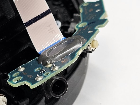

    • Using a Phillips #000 screwdriver, remove the 2 screws holding the daughter board into the earcup.

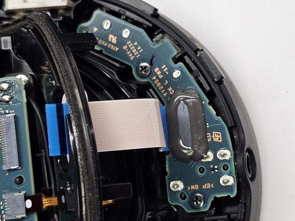

  8. Sony WH-1000XM5 3.5mm Jack Replacement / Debris Removal, Removing the Daughter Board: crwdns2935265:08crwdnd2935265:01crwdnd2935265:03crwdne2935265:0 Sony WH-1000XM5 3.5mm Jack Replacement / Debris Removal, Removing the Daughter Board: crwdns2935265:08crwdnd2935265:02crwdnd2935265:03crwdne2935265:0 Sony WH-1000XM5 3.5mm Jack Replacement / Debris Removal, Removing the Daughter Board: crwdns2935265:08crwdnd2935265:03crwdnd2935265:03crwdne2935265:0
    • With the screws removed from the board, you can now pry the daughter board from the earcup.
    • Using a plastic pry tool, spudger, or tweezers, carefully pry the board up and out of the housing.
    • Be careful when removing the board from the housing, as the ribbon cable is still attached to the main board. As long as it has been disconnected on the other end, you should have plenty of slack to safely remove the board.

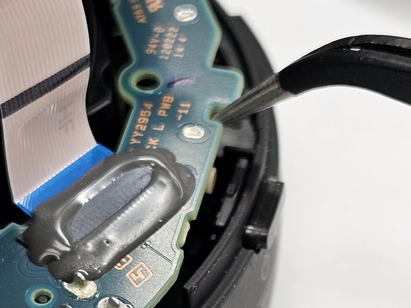

  9. Sony WH-1000XM5 3.5mm Jack Replacement / Debris Removal, Removing Plug Debris: crwdns2935265:09crwdnd2935265:01crwdnd2935265:01crwdne2935265:0
    • With the board removed, you can now safely replace any of the components on it, or even the entire assembly.
    • If removing plug debris, gently push any lodged debris out using tweezers.
    • Ensure that you push any debris out towards the "entrance" of the jack.
