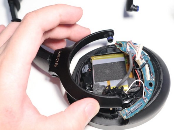

    • Using an opening tool, pry off the right ear muff and remove the underlying foam.
  2. Sony WH-1000XM4 Swivel Replacement, Right side, screws: crwdns2935265:02crwdnd2935265:01crwdnd2935265:01crwdne2935265:0
    • Remove the four silver screws on right side of the headphones using a Phillips #000 screwdriver.

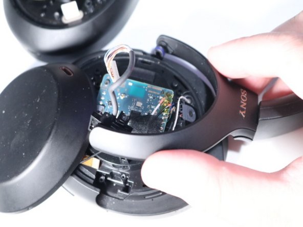

  3. Sony WH-1000XM4 Swivel Replacement, Right side, cup cover: crwdns2935265:03crwdnd2935265:01crwdnd2935265:02crwdne2935265:0 Sony WH-1000XM4 Swivel Replacement, Right side, cup cover: crwdns2935265:03crwdnd2935265:02crwdnd2935265:02crwdne2935265:0
    • Flip the headphones.
    • Lift up and flip the right ear cup cover.
    • Don't try to completely remove the cover just yet—it's still attached with the touch cable.

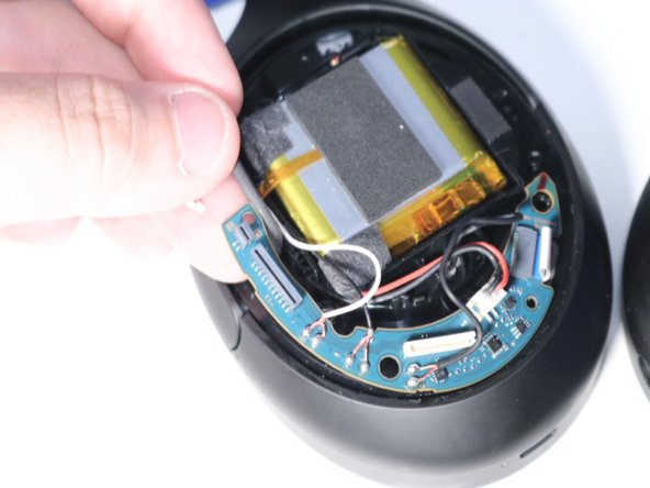

  4. Sony WH-1000XM4 Swivel Replacement, Right side, touch ribbon cable: crwdns2935265:04crwdnd2935265:01crwdnd2935265:02crwdne2935265:0 Sony WH-1000XM4 Swivel Replacement, Right side, touch ribbon cable: crwdns2935265:04crwdnd2935265:02crwdnd2935265:02crwdne2935265:0
    • Detach the ribbon cable connecting the backplate to the right ear.
  5. Sony WH-1000XM4 Swivel Replacement, Right side, thermal sensor ribbon cable: crwdns2935265:05crwdnd2935265:01crwdnd2935265:02crwdne2935265:0 Sony WH-1000XM4 Swivel Replacement, Right side, thermal sensor ribbon cable: crwdns2935265:05crwdnd2935265:02crwdnd2935265:02crwdne2935265:0
    • Detach the yellow thermal sensor ribbon cable from the motherboard.
  6. Sony WH-1000XM4 Swivel Replacement, Right side, white ribbon cable: crwdns2935265:06crwdnd2935265:01crwdnd2935265:02crwdne2935265:0 Sony WH-1000XM4 Swivel Replacement, Right side, white ribbon cable: crwdns2935265:06crwdnd2935265:02crwdnd2935265:02crwdne2935265:0
    • Disconnect the white ribbon cable.

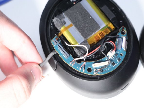

  7. Sony WH-1000XM4 Swivel Replacement, Right side, data/pwr connector: crwdns2935265:07crwdnd2935265:01crwdnd2935265:02crwdne2935265:0 Sony WH-1000XM4 Swivel Replacement, Right side, data/pwr connector: crwdns2935265:07crwdnd2935265:02crwdnd2935265:02crwdne2935265:0
    • Detach the data/pwr connector from the motherboard using an opening tool.
  8. Sony WH-1000XM4 Swivel Replacement, Right side, motherboard screws: crwdns2935265:08crwdnd2935265:01crwdnd2935265:01crwdne2935265:0
    • Remove the two screws from the motherboard using a Phillips #000 screwdriver.

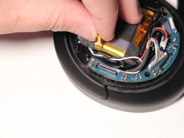

    • Move the data/pwr cable from the inside of the board to the outside.
  10. Sony WH-1000XM4 Swivel Replacement: crwdns2935265:010crwdnd2935265:01crwdnd2935265:01crwdne2935265:0
    • Remove the data/ pwr connector from board.

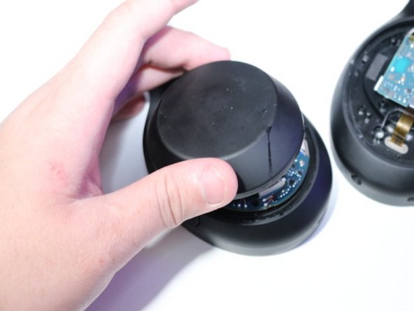

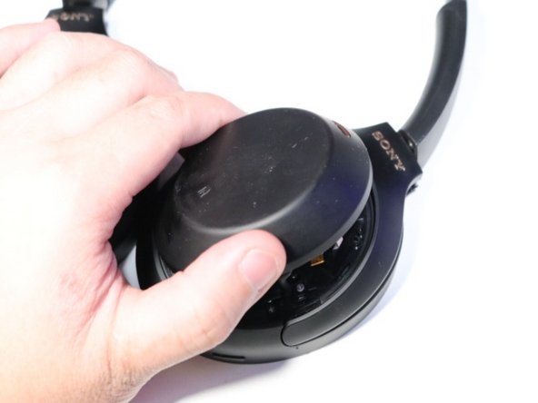

  15. Sony WH-1000XM4 Swivel Replacement, Left side, cup cover: crwdns2935265:015crwdnd2935265:01crwdnd2935265:02crwdne2935265:0 Sony WH-1000XM4 Swivel Replacement, Left side, cup cover: crwdns2935265:015crwdnd2935265:02crwdnd2935265:02crwdne2935265:0
    • Lift up and flip the left ear cup cover.

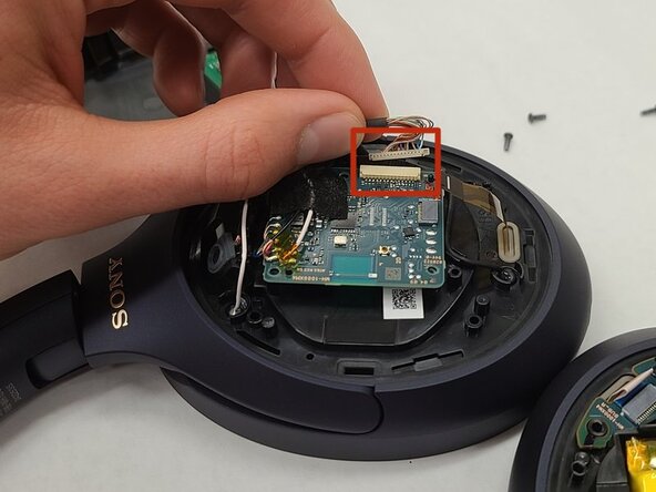

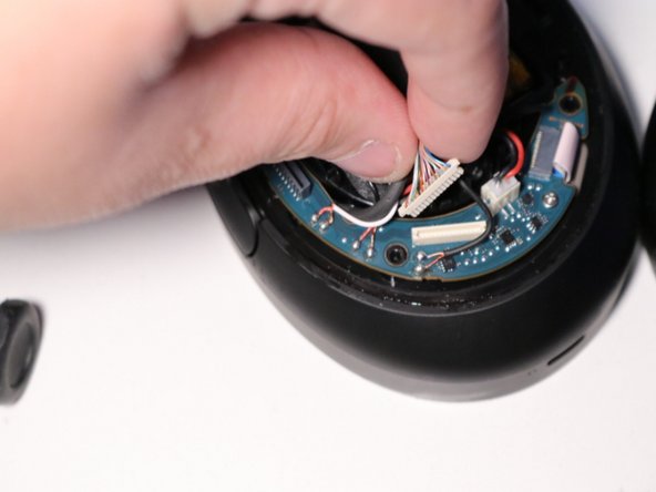

  16. Sony WH-1000XM4 Swivel Replacement, Left side, multipin connector: crwdns2935265:016crwdnd2935265:01crwdnd2935265:01crwdne2935265:0
    • On the left ear, detach the multipin connector (multiple colorful wires) from the back panel to the motherboard.

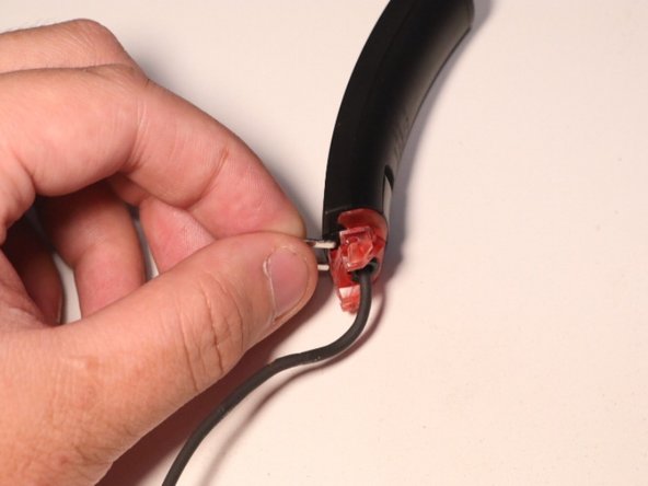

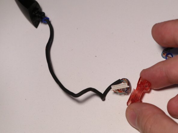

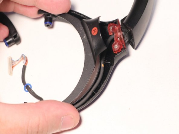

  19. Sony WH-1000XM4 Swivel Replacement, Commons steps, hinge removal: crwdns2935265:019crwdnd2935265:01crwdnd2935265:02crwdne2935265:0 Sony WH-1000XM4 Swivel Replacement, Commons steps, hinge removal: crwdns2935265:019crwdnd2935265:02crwdnd2935265:02crwdne2935265:0
    • Remove the black hinge piece from the data/ pwr cable.

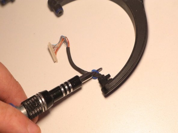

  20. Sony WH-1000XM4 Swivel Replacement: crwdns2935265:020crwdnd2935265:01crwdnd2935265:02crwdne2935265:0 Sony WH-1000XM4 Swivel Replacement: crwdns2935265:020crwdnd2935265:02crwdnd2935265:02crwdne2935265:0
    • Using a screwdriver, remove the rubber band.
  21. Sony WH-1000XM4 Swivel Replacement: crwdns2935265:021crwdnd2935265:01crwdnd2935265:02crwdne2935265:0 Sony WH-1000XM4 Swivel Replacement: crwdns2935265:021crwdnd2935265:02crwdnd2935265:02crwdne2935265:0
    • Use an opening tool to remove the cover.
  22. Sony WH-1000XM4 Swivel Replacement: crwdns2935265:022crwdnd2935265:01crwdnd2935265:01crwdne2935265:0
    • Lift up the data/ pwr cable.
  23. Sony WH-1000XM4 Swivel Replacement: crwdns2935265:023crwdnd2935265:01crwdnd2935265:01crwdne2935265:0
    • Remove the two screws from the swivel using a Phillips #000 screwdriver.

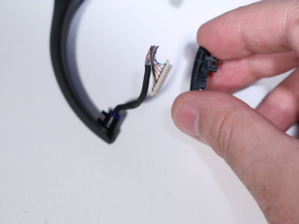

  24. Sony WH-1000XM4 Swivel Replacement: crwdns2935265:024crwdnd2935265:01crwdnd2935265:02crwdne2935265:0 Sony WH-1000XM4 Swivel Replacement: crwdns2935265:024crwdnd2935265:02crwdnd2935265:02crwdne2935265:0
    • Push out the metal bit from the swivel piece using a spudger.
    • Pull out the metal bit.
  25. Sony WH-1000XM4 Swivel Replacement: crwdns2935265:025crwdnd2935265:01crwdnd2935265:02crwdne2935265:0 Sony WH-1000XM4 Swivel Replacement: crwdns2935265:025crwdnd2935265:02crwdnd2935265:02crwdne2935265:0
    • Remove the old swivel.

really helpful, thank you! my swivel snapped. I started from Step 18 and removed the cover halfway. re-inserted the swivel then locked the metal bit back. i don't have the replacement piece and it will snap again if twisted too far, but this works for now. thanks!!
jianne - crwdns2934203:0crwdne2934203:0
