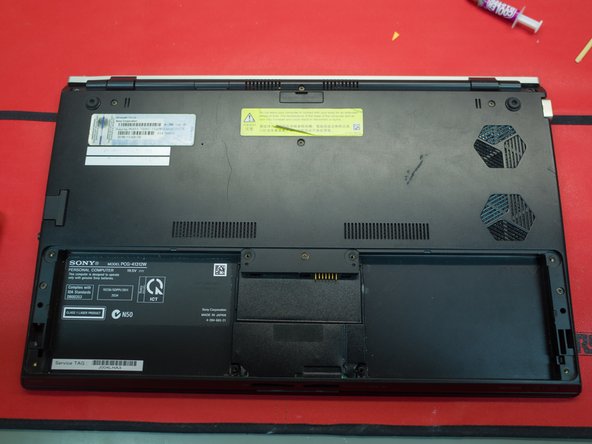

  2. Sony Vaio VPCZ2 CPU Heatsink Fan Assembly Replacement: crwdns2935265:02crwdnd2935265:01crwdnd2935265:03crwdne2935265:0 Sony Vaio VPCZ2 CPU Heatsink Fan Assembly Replacement: crwdns2935265:02crwdnd2935265:02crwdnd2935265:03crwdne2935265:0 Sony Vaio VPCZ2 CPU Heatsink Fan Assembly Replacement: crwdns2935265:02crwdnd2935265:03crwdnd2935265:03crwdne2935265:0

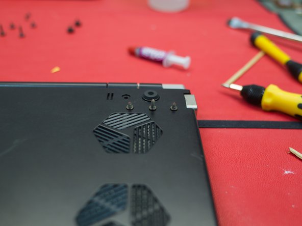

    • Remove the 8 screws holding in the battery
    • Remove the battery
    • Remove all other screws on the underside of the laptop
    • Under the battery there are three more screws to remove
    • There are two types of screws (other than the battery screws). In case you lose track; the longer screws go through the rubber feet

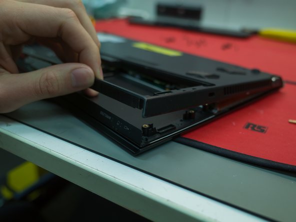

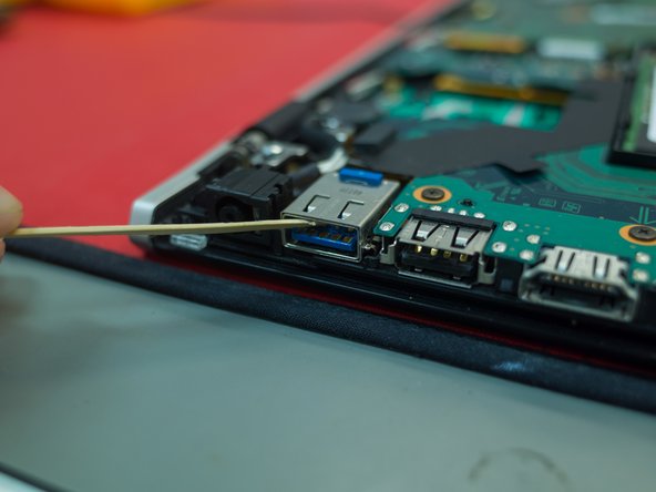

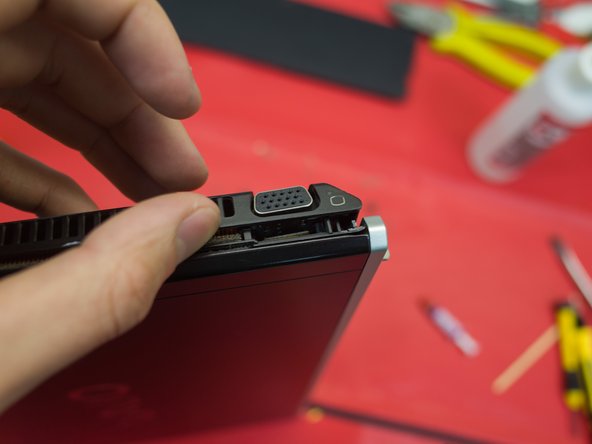

  3. Sony Vaio VPCZ2 CPU Heatsink Fan Assembly Replacement: crwdns2935265:03crwdnd2935265:01crwdnd2935265:03crwdne2935265:0 Sony Vaio VPCZ2 CPU Heatsink Fan Assembly Replacement: crwdns2935265:03crwdnd2935265:02crwdnd2935265:03crwdne2935265:0 Sony Vaio VPCZ2 CPU Heatsink Fan Assembly Replacement: crwdns2935265:03crwdnd2935265:03crwdnd2935265:03crwdne2935265:0
    • Pry the housing apart using something maliable (I used a bamboo stick)

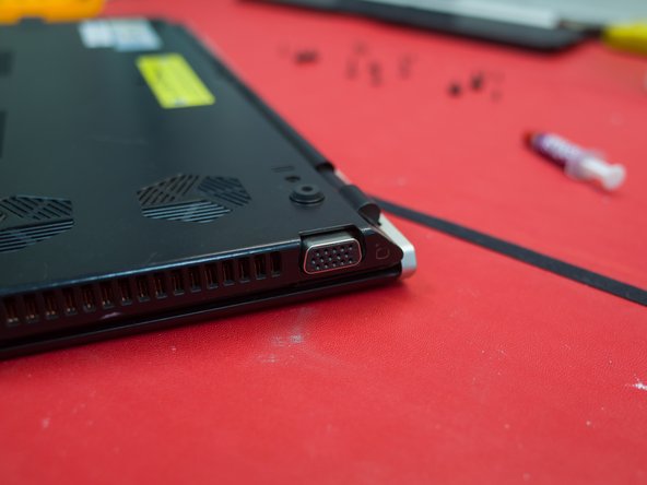

    • Start at the front edge on the side with the VGA port & fan hole
    • The VGA port is not fixed to the chassis, and can be lifted up to assist with removing the case
    • I have shown the VGA port in more detail later in this guide

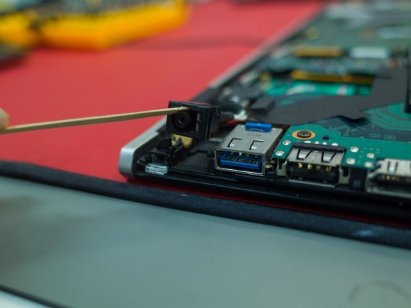

  5. Sony Vaio VPCZ2 CPU Heatsink Fan Assembly Replacement: crwdns2935265:05crwdnd2935265:01crwdnd2935265:03crwdne2935265:0 Sony Vaio VPCZ2 CPU Heatsink Fan Assembly Replacement: crwdns2935265:05crwdnd2935265:02crwdnd2935265:03crwdne2935265:0 Sony Vaio VPCZ2 CPU Heatsink Fan Assembly Replacement: crwdns2935265:05crwdnd2935265:03crwdnd2935265:03crwdne2935265:0

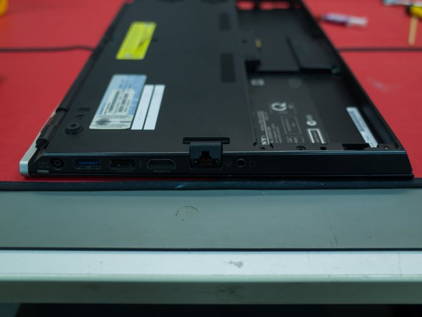

    • Working your way around the other side of the laptop, the case should slide easily over the ports (HDMI/USB etc.)
    • You may need to lift the Ethernet port flap
    • The headphone port, USB 3.0 port, and A/C jack should move freely, and are not directly fixed to the chassis.

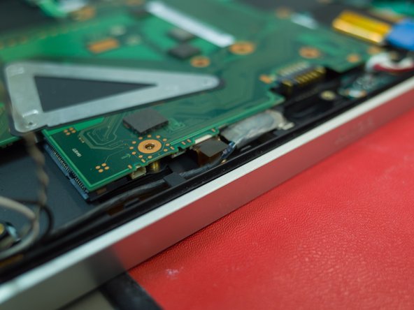

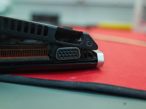

  6. Sony Vaio VPCZ2 CPU Heatsink Fan Assembly Replacement: crwdns2935265:06crwdnd2935265:01crwdnd2935265:01crwdne2935265:0
    • As you can see, the VGA port sits in a slot which allows it to move up and down. It is necessary to lift this port when taking the cover off.

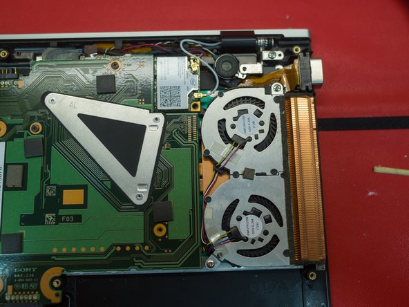

  7. Sony Vaio VPCZ2 CPU Heatsink Fan Assembly Replacement, Laptop inside view: crwdns2935265:07crwdnd2935265:01crwdnd2935265:03crwdne2935265:0 Sony Vaio VPCZ2 CPU Heatsink Fan Assembly Replacement, Laptop inside view: crwdns2935265:07crwdnd2935265:02crwdnd2935265:03crwdne2935265:0 Sony Vaio VPCZ2 CPU Heatsink Fan Assembly Replacement, Laptop inside view: crwdns2935265:07crwdnd2935265:03crwdnd2935265:03crwdne2935265:0
    • Note that screws are marked with an arrow. This is useful when reassembling the laptop, as some screws are not entirely obvious.
    • On the right is the fan & heatsink
    • The triangle bracket holds in the CPU (accessed from the under side of the motherboard)
    • The SSD is to the left of the motherboard
    • Above the SSD is the optical board. This handles the signal for the external dock (PMD), and is responsible for transfering data fast enough to power an external GPU.

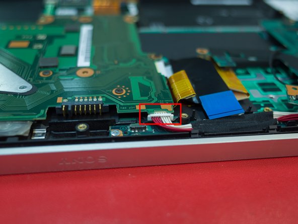

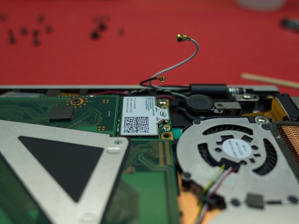

  8. Sony Vaio VPCZ2 CPU Heatsink Fan Assembly Replacement: crwdns2935265:08crwdnd2935265:01crwdnd2935265:02crwdne2935265:0 Sony Vaio VPCZ2 CPU Heatsink Fan Assembly Replacement: crwdns2935265:08crwdnd2935265:02crwdnd2935265:02crwdne2935265:0

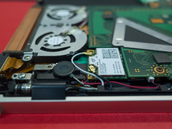

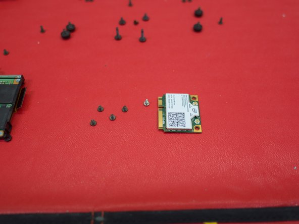

    • Un-plug the two cables holding in the wifi board
  9. Sony Vaio VPCZ2 CPU Heatsink Fan Assembly Replacement: crwdns2935265:09crwdnd2935265:01crwdnd2935265:01crwdne2935265:0

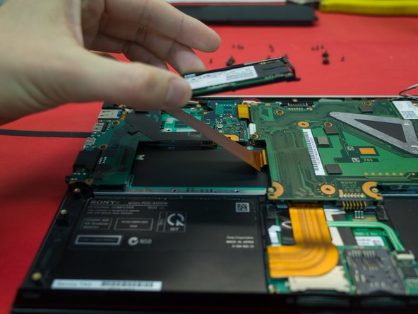

  11. Sony Vaio VPCZ2 CPU Heatsink Fan Assembly Replacement: crwdns2935265:011crwdnd2935265:01crwdnd2935265:02crwdne2935265:0 Sony Vaio VPCZ2 CPU Heatsink Fan Assembly Replacement: crwdns2935265:011crwdnd2935265:02crwdnd2935265:02crwdne2935265:0

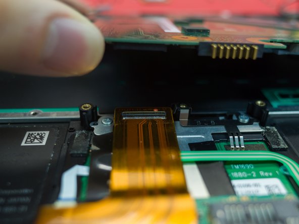

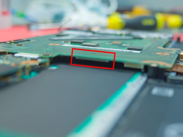

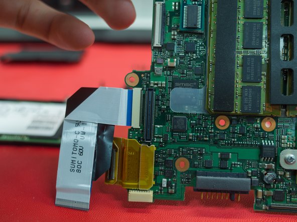

    • The SSD is attached to the motherboard with a flat ribbon cable. This should just pull out.
    • I have over-exposed the second image to highlight where the SSD connector is on the motherboard.

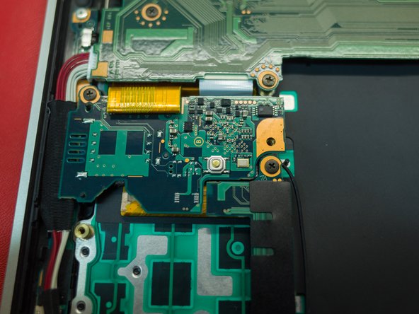

  13. Sony Vaio VPCZ2 CPU Heatsink Fan Assembly Replacement: crwdns2935265:013crwdnd2935265:01crwdnd2935265:03crwdne2935265:0 Sony Vaio VPCZ2 CPU Heatsink Fan Assembly Replacement: crwdns2935265:013crwdnd2935265:02crwdnd2935265:03crwdne2935265:0 Sony Vaio VPCZ2 CPU Heatsink Fan Assembly Replacement: crwdns2935265:013crwdnd2935265:03crwdnd2935265:03crwdne2935265:0
    • Remove the optical board (2 screws)
    • Remove the plug from the optical board to the motherboard (should pull directly up)

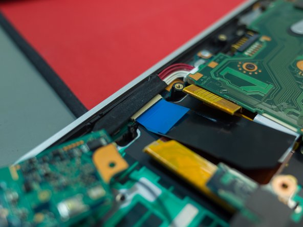

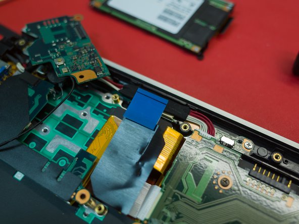

  14. Sony Vaio VPCZ2 CPU Heatsink Fan Assembly Replacement: crwdns2935265:014crwdnd2935265:01crwdnd2935265:02crwdne2935265:0 Sony Vaio VPCZ2 CPU Heatsink Fan Assembly Replacement: crwdns2935265:014crwdnd2935265:02crwdnd2935265:02crwdne2935265:0
    • Hold the blue plastic tab to remove the flat ribbon cable to the motherboard. This should pull straight out horizontally.

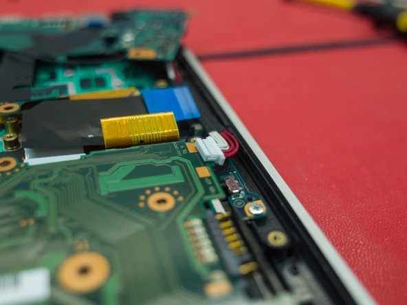

  15. Sony Vaio VPCZ2 CPU Heatsink Fan Assembly Replacement: crwdns2935265:015crwdnd2935265:01crwdnd2935265:02crwdne2935265:0 Sony Vaio VPCZ2 CPU Heatsink Fan Assembly Replacement: crwdns2935265:015crwdnd2935265:02crwdnd2935265:02crwdne2935265:0

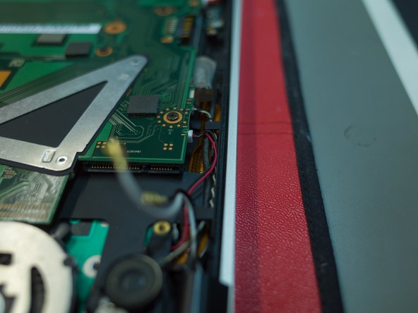

    • On the back edge there are 4 plugs going into the back of the motherboard.
    • I'm not 100% sure, but from the top of my head these are (left to right); speakers (red/black & black/white), VGA (ribbon), and main (flat plug type)
    • There is also a power connector plug on the far side (red/white)

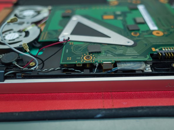

  16. Sony Vaio VPCZ2 CPU Heatsink Fan Assembly Replacement: crwdns2935265:016crwdnd2935265:01crwdnd2935265:03crwdne2935265:0 Sony Vaio VPCZ2 CPU Heatsink Fan Assembly Replacement: crwdns2935265:016crwdnd2935265:02crwdnd2935265:03crwdne2935265:0 Sony Vaio VPCZ2 CPU Heatsink Fan Assembly Replacement: crwdns2935265:016crwdnd2935265:03crwdnd2935265:03crwdne2935265:0
    • The red/white and black/white plugs are obvious to pull out
    • The VGA cable has a flat plastic tab - pull on this tab to remove/install
    • The red/white power cables are also obvious
    • To remove the main plug, push it straight down towards the keyboard. This is easier to do once the motherboard is free, so I would suggest leaving it in place for now.

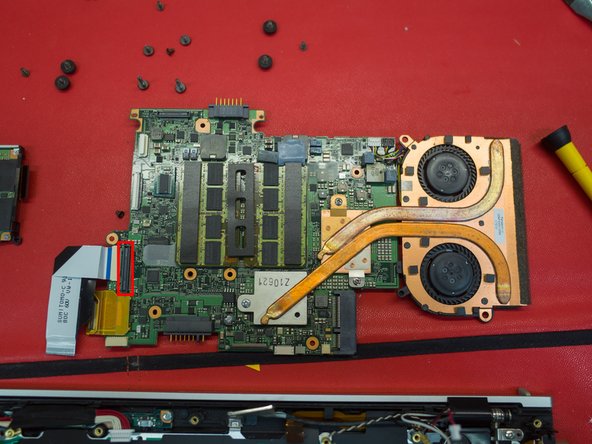

  17. Sony Vaio VPCZ2 CPU Heatsink Fan Assembly Replacement: crwdns2935265:017crwdnd2935265:01crwdnd2935265:02crwdne2935265:0 Sony Vaio VPCZ2 CPU Heatsink Fan Assembly Replacement: crwdns2935265:017crwdnd2935265:02crwdnd2935265:02crwdne2935265:0

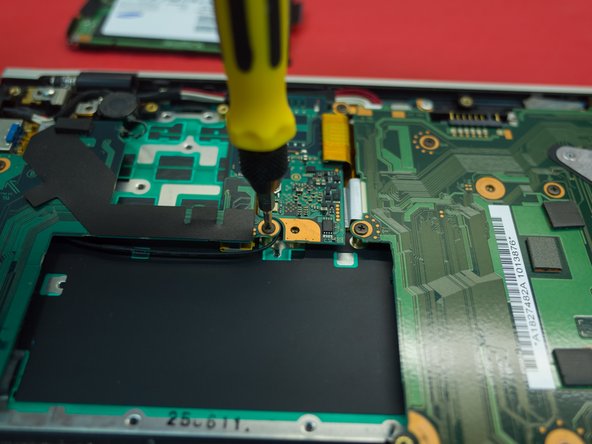

    • Remove the screws holding in the motherboard (6, including the wifi board)
  18. Sony Vaio VPCZ2 CPU Heatsink Fan Assembly Replacement: crwdns2935265:018crwdnd2935265:01crwdnd2935265:02crwdne2935265:0 Sony Vaio VPCZ2 CPU Heatsink Fan Assembly Replacement: crwdns2935265:018crwdnd2935265:02crwdnd2935265:02crwdne2935265:0

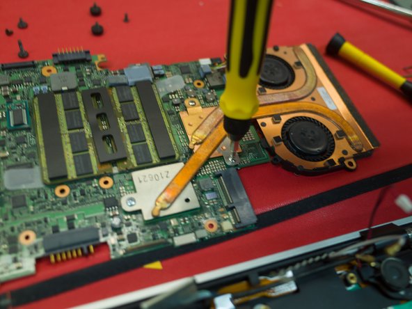

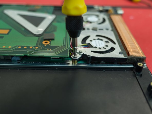

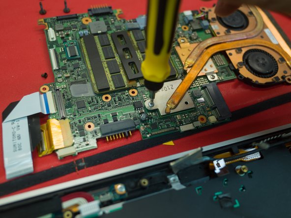

    • Remove the two screws holding in the fan and heatsink
  19. Sony Vaio VPCZ2 CPU Heatsink Fan Assembly Replacement: crwdns2935265:019crwdnd2935265:01crwdnd2935265:01crwdne2935265:0
    • The heatsink and fan and connected directly to the motherboard by 3 screws. These screws are attached to the triangle bracket, and are accessible from the under side of the motherboard.
    • This means that the entire motherboard needs to be disconnected to remove the CPU, fan, and heatsink.

  21. Sony Vaio VPCZ2 CPU Heatsink Fan Assembly Replacement: crwdns2935265:021crwdnd2935265:01crwdnd2935265:01crwdne2935265:0
    • You can see the remaining connectors on the motherboard
  22. Sony Vaio VPCZ2 CPU Heatsink Fan Assembly Replacement: crwdns2935265:022crwdnd2935265:01crwdnd2935265:03crwdne2935265:0 Sony Vaio VPCZ2 CPU Heatsink Fan Assembly Replacement: crwdns2935265:022crwdnd2935265:02crwdnd2935265:03crwdne2935265:0 Sony Vaio VPCZ2 CPU Heatsink Fan Assembly Replacement: crwdns2935265:022crwdnd2935265:03crwdnd2935265:03crwdne2935265:0
    • Underside view of removed motherboard. Here you can see the plug type and RAM
    • Note the plug type for the main motherboard cable (circled)
    • You can also see the three screws for the heatsink and fan assembly.

    • Remove the three screws holding on the heatsink and fan assembly.
    • Note; there are two different screw lengths for this assembly

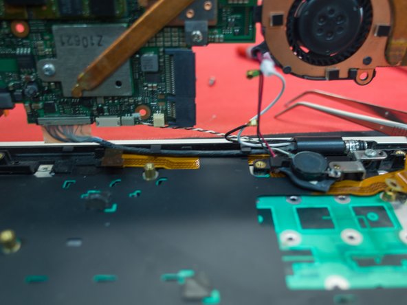

    • Attach the speaker cables & VGA port
    • Note: be careful with the cabling here. Pay attention to how the cables sit, and make sure they are not going to be pinched by other pieces.
    • I actually damaged the VGA cable when I did this the first time. It was a cheap part to fix, but again - be careful, you can damage these parts.
  37. Sony Vaio VPCZ2 CPU Heatsink Fan Assembly Replacement: crwdns2935265:037crwdnd2935265:01crwdnd2935265:02crwdne2935265:0 Sony Vaio VPCZ2 CPU Heatsink Fan Assembly Replacement: crwdns2935265:037crwdnd2935265:02crwdnd2935265:02crwdne2935265:0
    • Replace the wifi card and plug up the white and black cables

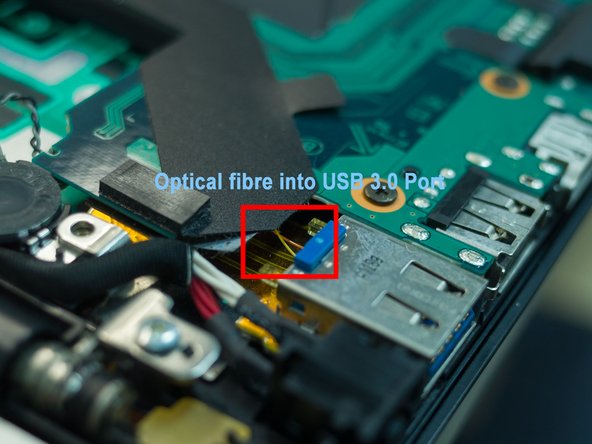

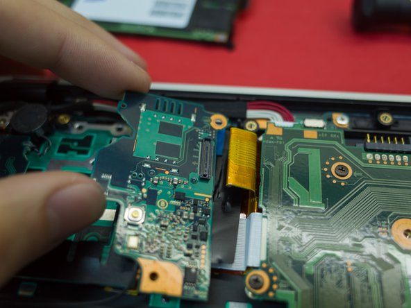

    • This is the optical board. You can see here the two optical fibre cables that go into the USB 3.0 port to communicate with the optional Power Media Dock (PMD).
    • I believe they use fibre for this application because of the bandwidth required to run an external GPU
  41. Sony Vaio VPCZ2 CPU Heatsink Fan Assembly Replacement: crwdns2935265:041crwdnd2935265:01crwdnd2935265:02crwdne2935265:0 Sony Vaio VPCZ2 CPU Heatsink Fan Assembly Replacement: crwdns2935265:041crwdnd2935265:02crwdnd2935265:02crwdne2935265:0
    • Replace the two screws holding the optical board.
    • The optical board tends to spring up, and you may need to hold it down while you screw it back in.
    • Pay attention to where that optical cable goes - this is relatively fragile, you don't want it getting caught between a screw or a board.

  45. Sony Vaio VPCZ2 CPU Heatsink Fan Assembly Replacement: crwdns2935265:045crwdnd2935265:01crwdnd2935265:03crwdne2935265:0 Sony Vaio VPCZ2 CPU Heatsink Fan Assembly Replacement: crwdns2935265:045crwdnd2935265:02crwdnd2935265:03crwdne2935265:0 Sony Vaio VPCZ2 CPU Heatsink Fan Assembly Replacement: crwdns2935265:045crwdnd2935265:03crwdnd2935265:03crwdne2935265:0
    • Around the otherside, lift the VGA port up and align it in the case before lowering the case onto the chassis
  46. Sony Vaio VPCZ2 CPU Heatsink Fan Assembly Replacement: crwdns2935265:046crwdnd2935265:01crwdnd2935265:03crwdne2935265:0 Sony Vaio VPCZ2 CPU Heatsink Fan Assembly Replacement: crwdns2935265:046crwdnd2935265:02crwdnd2935265:03crwdne2935265:0 Sony Vaio VPCZ2 CPU Heatsink Fan Assembly Replacement: crwdns2935265:046crwdnd2935265:03crwdnd2935265:03crwdne2935265:0

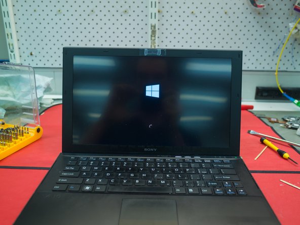

    • Replace the screws, fire it up!
  47. Sony Vaio VPCZ2 CPU Heatsink Fan Assembly Replacement: crwdns2935265:047crwdnd2935265:01crwdnd2935265:02crwdne2935265:0 Sony Vaio VPCZ2 CPU Heatsink Fan Assembly Replacement: crwdns2935265:047crwdnd2935265:02crwdnd2935265:02crwdne2935265:0
    • Success!
