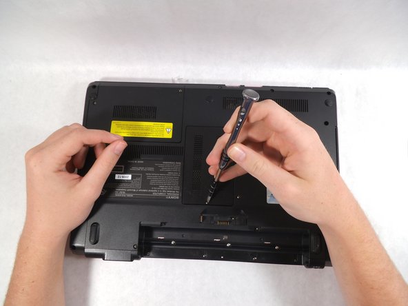

  3. Sony Vaio VPCW21FX RAM Replacement, RAM: crwdns2935265:03crwdnd2935265:01crwdnd2935265:03crwdne2935265:0 Sony Vaio VPCW21FX RAM Replacement, RAM: crwdns2935265:03crwdnd2935265:02crwdnd2935265:03crwdne2935265:0 Sony Vaio VPCW21FX RAM Replacement, RAM: crwdns2935265:03crwdnd2935265:03crwdnd2935265:03crwdne2935265:0
    • Loosen but do not remove the screw over RAM cover panel.
    • With the screw loosened but not removed, lift up and remove the panel.
