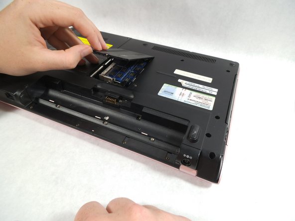

    • Slide the "release" switch to the left and gently lift the battery up to remove it.
    • Completely remove the battery from the device.

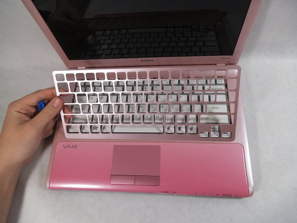

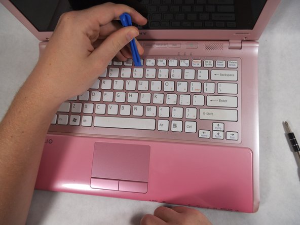

    • Open the Lid of the laptop
    • Then using they pry tool to carefully remove the plastic cover around the keyboard
    • It helps to pry from one of the larger keys as they have more room to fit the tool in

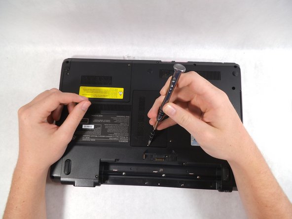

    • Close the lid and flip the laptop over
    • Loosen but do not remove the screw on center panel and remove Panel.

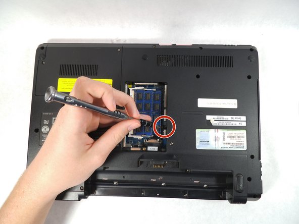

    • Remove the three 5mm screws that are holding in the keyboard.

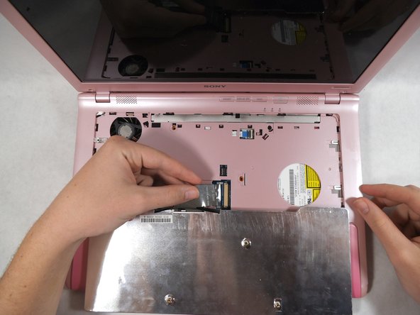

    • Flip laptop over again and open the lid
    • Lift up the keyboard from the top and lean it toward you to expose the connector on the back
    • Grab the wire from the keyboard close to the connector and pull carefully to the left to disconnect it from the laptop.
