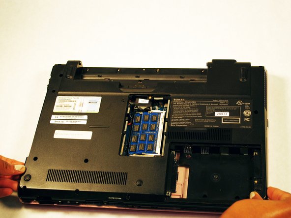

  4. Sony Vaio VPCW21FX Keyboard Replacement, Headphone Jack: crwdns2935265:04crwdnd2935265:01crwdnd2935265:02crwdne2935265:0 Sony Vaio VPCW21FX Keyboard Replacement, Headphone Jack: crwdns2935265:04crwdnd2935265:02crwdnd2935265:02crwdne2935265:0

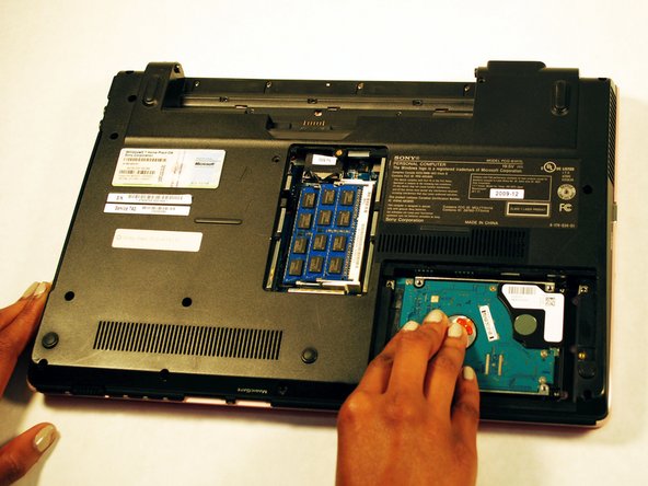

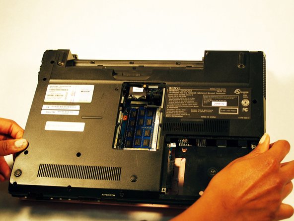

    • Place the laptop upside down with the bottom panel facing upwards.

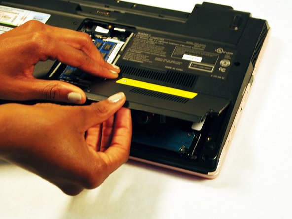

    • Locate the screw that holds the small panel covering your laptop's Ram. This panel should be in the dead center of your laptop.
    • Unscrew the screw and remove the panel.
  5. Sony Vaio VPCW21FX Keyboard Replacement: crwdns2935265:05crwdnd2935265:01crwdnd2935265:01crwdne2935265:0
    • Before you move away from where your RAM is located, be sure to unplug the wire labeled To MB. If you do not unplug this, the back panel you are trying to remove will not come off.
  6. Sony Vaio VPCW21FX Keyboard Replacement: crwdns2935265:06crwdnd2935265:01crwdnd2935265:03crwdne2935265:0 Sony Vaio VPCW21FX Keyboard Replacement: crwdns2935265:06crwdnd2935265:02crwdnd2935265:03crwdne2935265:0 Sony Vaio VPCW21FX Keyboard Replacement: crwdns2935265:06crwdnd2935265:03crwdnd2935265:03crwdne2935265:0

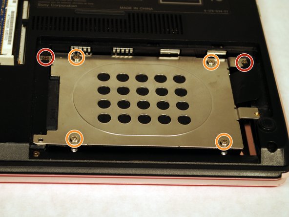

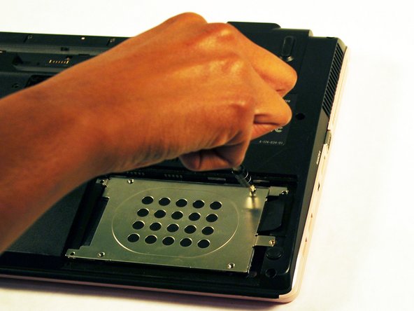

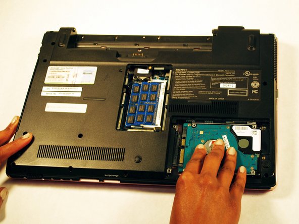

    • Next, locate the panel covering your laptop's hard drive. This panel should be located on the lower right hand side of your laptop.
    • Unscrew the cover on the hard drive.
    • Remove the hard drive cover.
  7. Sony Vaio VPCW21FX Keyboard Replacement: crwdns2935265:07crwdnd2935265:01crwdnd2935265:03crwdne2935265:0 Sony Vaio VPCW21FX Keyboard Replacement: crwdns2935265:07crwdnd2935265:02crwdnd2935265:03crwdne2935265:0 Sony Vaio VPCW21FX Keyboard Replacement: crwdns2935265:07crwdnd2935265:03crwdnd2935265:03crwdne2935265:0
    • Remove screws.
    • Remove screws and remove panel.
  8. Sony Vaio VPCW21FX Keyboard Replacement: crwdns2935265:08crwdnd2935265:01crwdnd2935265:03crwdne2935265:0 Sony Vaio VPCW21FX Keyboard Replacement: crwdns2935265:08crwdnd2935265:02crwdnd2935265:03crwdne2935265:0 Sony Vaio VPCW21FX Keyboard Replacement: crwdns2935265:08crwdnd2935265:03crwdnd2935265:03crwdne2935265:0
    • Remove the hard drive by gently pressing down on it and sliding it to the right.
    • Remember to have a clean work space to place the parts you take off your laptop. It'd be embarrassing to forget to reassemble a part or have a screw or two left over.
  9. Sony Vaio VPCW21FX Keyboard Replacement: crwdns2935265:09crwdnd2935265:01crwdnd2935265:03crwdne2935265:0 Sony Vaio VPCW21FX Keyboard Replacement: crwdns2935265:09crwdnd2935265:02crwdnd2935265:03crwdne2935265:0 Sony Vaio VPCW21FX Keyboard Replacement: crwdns2935265:09crwdnd2935265:03crwdnd2935265:03crwdne2935265:0

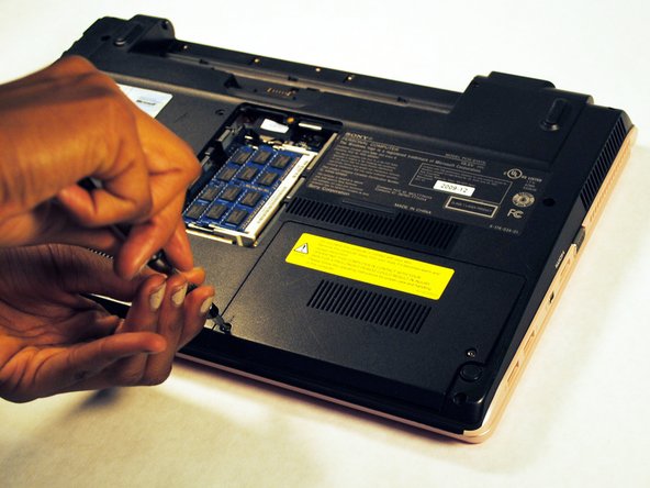

    • Remove the screws holding the rest of the outside panel down.
    • Gently lift the panel up to remove it once all the screws have been removed.

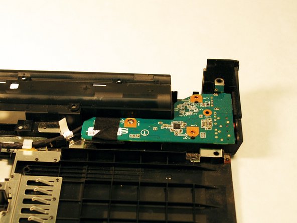

  10. Sony Vaio VPCW21FX Keyboard Replacement: crwdns2935265:010crwdnd2935265:01crwdnd2935265:03crwdne2935265:0 Sony Vaio VPCW21FX Keyboard Replacement: crwdns2935265:010crwdnd2935265:02crwdnd2935265:03crwdne2935265:0 Sony Vaio VPCW21FX Keyboard Replacement: crwdns2935265:010crwdnd2935265:03crwdnd2935265:03crwdne2935265:0

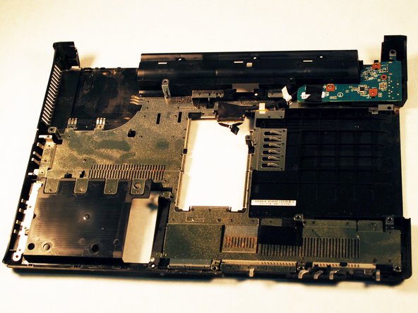

    • Once the back panel has been removed, set the rest of your laptop to the side and place the panel you just removed in front of you.

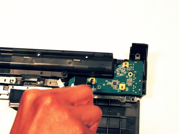

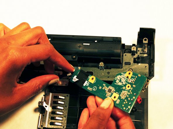

    • Locate the headphone jack, which will be in the top right hand corner of the panel. The headphone jack board is a bright green, you can't miss it.
  11. Sony Vaio VPCW21FX Keyboard Replacement: crwdns2935265:011crwdnd2935265:01crwdnd2935265:02crwdne2935265:0 Sony Vaio VPCW21FX Keyboard Replacement: crwdns2935265:011crwdnd2935265:02crwdnd2935265:02crwdne2935265:0
    • Remove the screws holding the headphone jack board down.
  12. Sony Vaio VPCW21FX Keyboard Replacement: crwdns2935265:012crwdnd2935265:01crwdnd2935265:02crwdne2935265:0 Sony Vaio VPCW21FX Keyboard Replacement: crwdns2935265:012crwdnd2935265:02crwdnd2935265:02crwdne2935265:0
    • Gently pull the board to remove it.

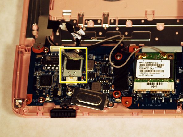

    • Remove screws.
    • Slide the small silver panel to the right to expose the wire underneath.
    • Gently pull on the small green board where the wire is connected to disconnect it.

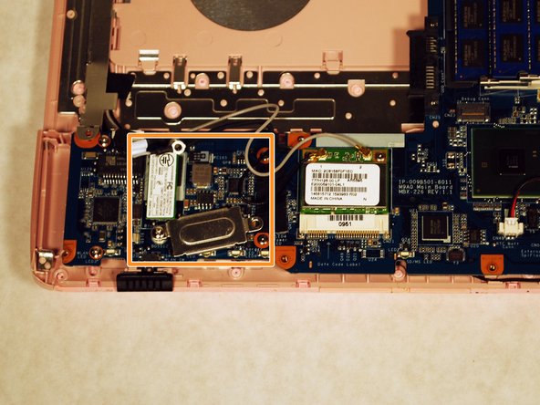

  15. Sony Vaio VPCW21FX Keyboard Replacement: crwdns2935265:015crwdnd2935265:01crwdnd2935265:02crwdne2935265:0 Sony Vaio VPCW21FX Keyboard Replacement: crwdns2935265:015crwdnd2935265:02crwdnd2935265:02crwdne2935265:0
    • Remove wires.
    • Remember to move the wires away from the motherboard after disconnecting them. This will avoid them getting caught when you try to lift the motherboard.

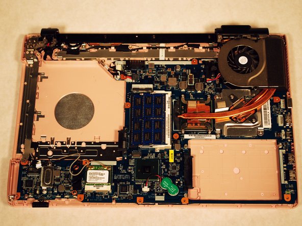

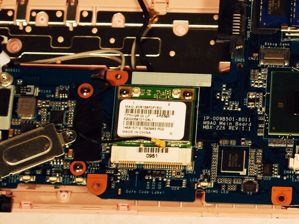

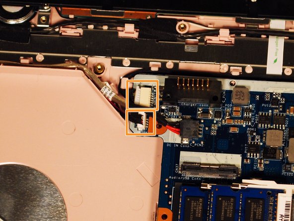

  16. Sony Vaio VPCW21FX Keyboard Replacement: crwdns2935265:016crwdnd2935265:01crwdnd2935265:02crwdne2935265:0 Sony Vaio VPCW21FX Keyboard Replacement: crwdns2935265:016crwdnd2935265:02crwdnd2935265:02crwdne2935265:0
    • Remove these two screws near the fan.
    • Disconnect the two wires connecting the motherboard to the charging port, these are located above the space where your CD drive was.
    • If you do not disconnect these two wires you won't be able to lift the motherboard up to disconnect the keyboard.
  17. Sony Vaio VPCW21FX Keyboard Replacement: crwdns2935265:017crwdnd2935265:01crwdnd2935265:01crwdne2935265:0
    • Lift up the motherboard.
    • Gently disconnect the large green wire underneath the motherboard that is connected to the keyboard.
    • The wire that is connected to the keyboard is thick and may take a little effort to unplug.

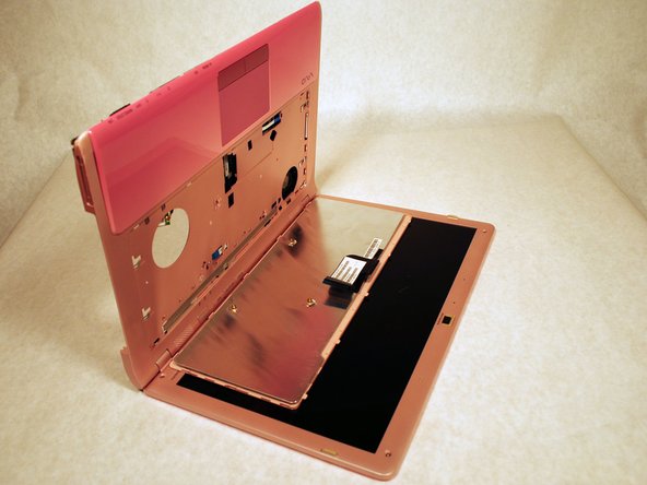

  18. Sony Vaio VPCW21FX Keyboard Replacement: crwdns2935265:018crwdnd2935265:01crwdnd2935265:02crwdne2935265:0 Sony Vaio VPCW21FX Keyboard Replacement: crwdns2935265:018crwdnd2935265:02crwdnd2935265:02crwdne2935265:0

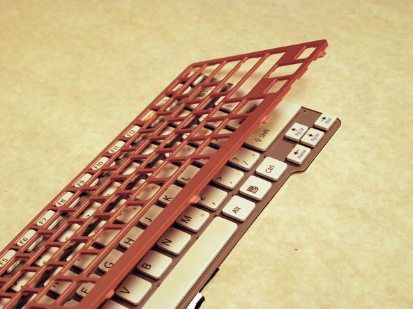

    • With the laptop open, gently push on the silver circle shown. This is the back side of the keyboard and will cause the keyboard to pop out.

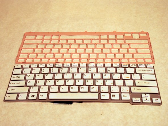

  19. Sony Vaio VPCW21FX Keyboard Replacement: crwdns2935265:019crwdnd2935265:01crwdnd2935265:03crwdne2935265:0 Sony Vaio VPCW21FX Keyboard Replacement: crwdns2935265:019crwdnd2935265:02crwdnd2935265:03crwdne2935265:0 Sony Vaio VPCW21FX Keyboard Replacement: crwdns2935265:019crwdnd2935265:03crwdnd2935265:03crwdne2935265:0
    • Gently pry the pink cover off the keyboard itself.
