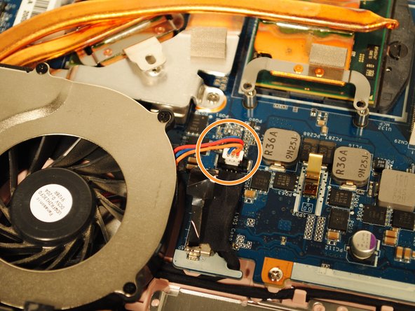

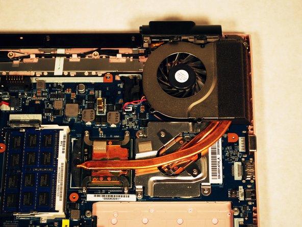

    • Locate the fan on the top right hand corner of your laptop.
  14. Sony Vaio VPCW21FX Fan Replacement: crwdns2935265:014crwdnd2935265:01crwdnd2935265:02crwdne2935265:0 Sony Vaio VPCW21FX Fan Replacement: crwdns2935265:014crwdnd2935265:02crwdnd2935265:02crwdne2935265:0
    • Remove screws.
    • Unplug the wires connecting the fan and the motherboard.
  15. Sony Vaio VPCW21FX Fan Replacement: crwdns2935265:015crwdnd2935265:01crwdnd2935265:01crwdne2935265:0
    • Gently pick up the fan to remove it.
