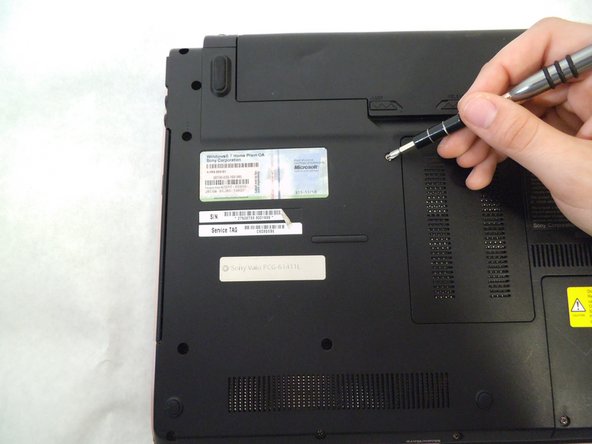

  4. Sony Vaio VPCW21FX Disc Drive Replacement, Disc Drive: crwdns2935265:04crwdnd2935265:01crwdnd2935265:02crwdne2935265:0 Sony Vaio VPCW21FX Disc Drive Replacement, Disc Drive: crwdns2935265:04crwdnd2935265:02crwdnd2935265:02crwdne2935265:0
    • Remove the four 5.2mm screws that are holding in the Disc Drive.

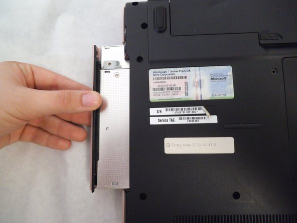

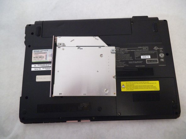

  5. Sony Vaio VPCW21FX Disc Drive Replacement: crwdns2935265:05crwdnd2935265:01crwdnd2935265:03crwdne2935265:0 Sony Vaio VPCW21FX Disc Drive Replacement: crwdns2935265:05crwdnd2935265:02crwdnd2935265:03crwdne2935265:0 Sony Vaio VPCW21FX Disc Drive Replacement: crwdns2935265:05crwdnd2935265:03crwdnd2935265:03crwdne2935265:0
    • Grab the center of the drive and pull away from the computer. It should slide right out.
    • The plastic face plate may come off, this is okay, just push it back into place on the drive
