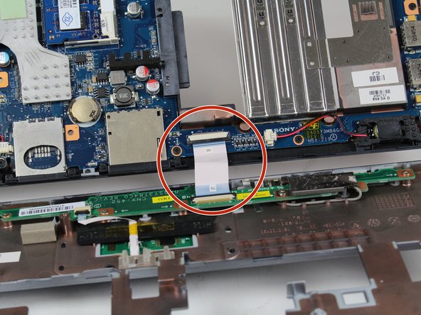

  7. Sony Vaio VPCW211AX RAM  Replacement: crwdns2935265:07crwdnd2935265:01crwdnd2935265:02crwdne2935265:0 Sony Vaio VPCW211AX RAM  Replacement: crwdns2935265:07crwdnd2935265:02crwdnd2935265:02crwdne2935265:0
    • Open the top carefully without disconnecting the two parts.
    • Be mindful and careful of the ribbon cable attaching the two parts together.

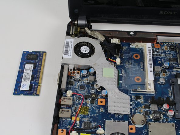

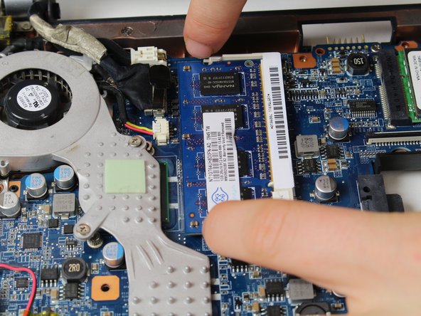

    • Using your fingers, pry apart the two side metal pieces that hold the part in place as shown on the picture.
  9. Sony Vaio VPCW211AX RAM  Replacement: crwdns2935265:09crwdnd2935265:01crwdnd2935265:01crwdne2935265:0
    • After that step, the RAM should pop up on its own as shown in the picture.
  10. Sony Vaio VPCW211AX RAM  Replacement: crwdns2935265:010crwdnd2935265:01crwdnd2935265:02crwdne2935265:0 Sony Vaio VPCW211AX RAM  Replacement: crwdns2935265:010crwdnd2935265:02crwdnd2935265:02crwdne2935265:0
    • Carefully press the sides near the right edge of the part and remove it from it's base.
