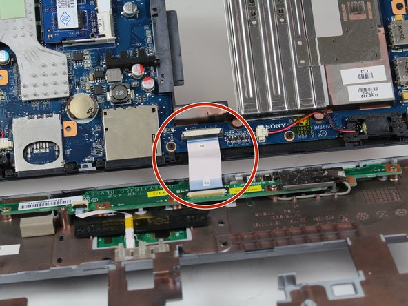

  7. Sony Vaio VPCW211AX Fan Replacement: crwdns2935265:07crwdnd2935265:01crwdnd2935265:02crwdne2935265:0 Sony Vaio VPCW211AX Fan Replacement: crwdns2935265:07crwdnd2935265:02crwdnd2935265:02crwdne2935265:0
    • Open the top carefully without disconnecting the two parts.
    • Be mindful and careful of the ribbon cable attaching the two parts together.

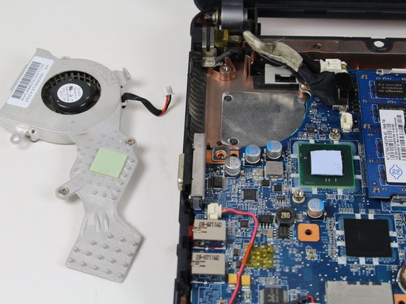

  10. Sony Vaio VPCW211AX Fan Replacement: crwdns2935265:010crwdnd2935265:01crwdnd2935265:01crwdne2935265:0
    • Using the plastic opening tool, pry up the unscrewed fan.
  11. Sony Vaio VPCW211AX Fan Replacement: crwdns2935265:011crwdnd2935265:01crwdnd2935265:02crwdne2935265:0 Sony Vaio VPCW211AX Fan Replacement: crwdns2935265:011crwdnd2935265:02crwdnd2935265:02crwdne2935265:0
    • The fan will still be attached by a small red and yellow wire, with your fingers detach this carefully.
    • Remove the fan.
