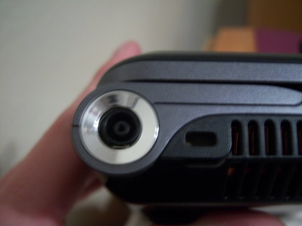

    • Does your charging port look like this, with two pins one on top of the other.
    • It should have a plastic post in the middle with those pins contained inside.
    • Odds are if you carry your laptop around a lot you've bumped the plug and it broke that post out and your plug suddenly got all loose and wobbly.
    • The first step is to buy the replacement DC jack.
    • Then check out the remaining steps to replace that worn out DC jack with your new one.

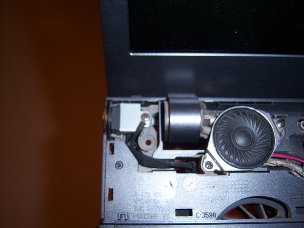

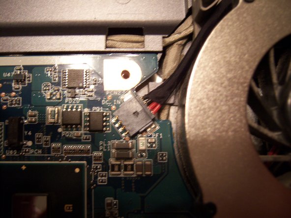

    • Now you should see a cord running around the outside of the fan with two red wires and two black wires, this is the dc jack wires.
    • Unplug this connector, gently.
    • Now flip the computer over and pop off the panel containing the speaker grille. There are multiple clips along its length. I just stuck my fingernail under its left edge next to the dc jack's chrome trim and pried it up gently and worked my way across until it completely popped off.
    • Remember these are small plastic clips so go slowly and cautiously.
    • Now you should see the other side of that dc jack wire coming up through a hole and going to (where else) the dc jack.
    • Remove the one screw on top and pull the metal cover off.
    • This part is tricky. Pull back on the jack and up at the same time so it pulls out of the hole. It takes a little work just be careful not to break the nice shiny chrome trim. Using needle nose pliers around the plastic body of the jack may help.
  5. Sony Vaio VPCF126FM DC Charger Jack Replacement: crwdns2935265:05crwdnd2935265:01crwdnd2935265:02crwdne2935265:0 Sony Vaio VPCF126FM DC Charger Jack Replacement: crwdns2935265:05crwdnd2935265:02crwdnd2935265:02crwdne2935265:0
    • Now that the old wobbly jack is out, pull the rest of the wires through the hole in the frame.
    • Then feed the wires of the new jack through that same hole.
    • On my replacement, there was a ferrite bead halfway along the wire, wrapped in shrinkable tube insulation, which together was too large to feed through the case. I had to carefully snip away the tube, feed through the wires, and slip on a fresh piece of 10mm shrink tube from the other side.
    • The new jack should go in easier than the old one came out. Make sure it is aligned the same as the old one with the wires going away from the screen, and snap it in.
    • Then put that metal cover back over it and place the short wire with the ring terminal on top of that, then re-install the screw through that connector and tighten it down.
    • Beware: On my replacement jack, the metal cover was so tight to the positive wire (nearest the top of the jack) that it shorted out after reassembly (the green light on the power brick cut out as soon as I plugged it in).
    • I used needle nose pliers to open out the right angle of the metal cover, away from the wire, and added a small piece of insulating tape under it to prevent shorting.

    • Now carefully snap the speaker grille back into place and flip the laptop over onto its back and take the wires from the dc jack and route them the same way the old one was.
    • Then reconnect the plug with two red wires and two black wires and push it all the way in.
