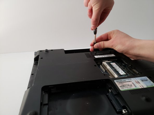

    • Remove the 9mm Phillips #1 screw located on the back cover.
    • Remove cover.

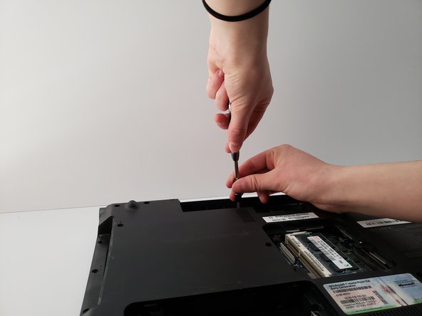

    • Remove the 9mm Phillips #1 screw holding the disk drive in place.
    • Remove the 9mm screw near the memory stick.

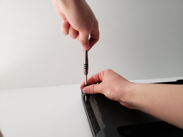

    • Remove three 3mm Phillips #1 screws on the side panel.
  9. Sony Vaio VPCF115FM Back Panel Assembly Replacement: crwdns2935265:09crwdnd2935265:01crwdnd2935265:03crwdne2935265:0 Sony Vaio VPCF115FM Back Panel Assembly Replacement: crwdns2935265:09crwdnd2935265:02crwdnd2935265:03crwdne2935265:0 Sony Vaio VPCF115FM Back Panel Assembly Replacement: crwdns2935265:09crwdnd2935265:03crwdnd2935265:03crwdne2935265:0
    • On the top of the panel, remove four 3mm Phillips #1 screws.

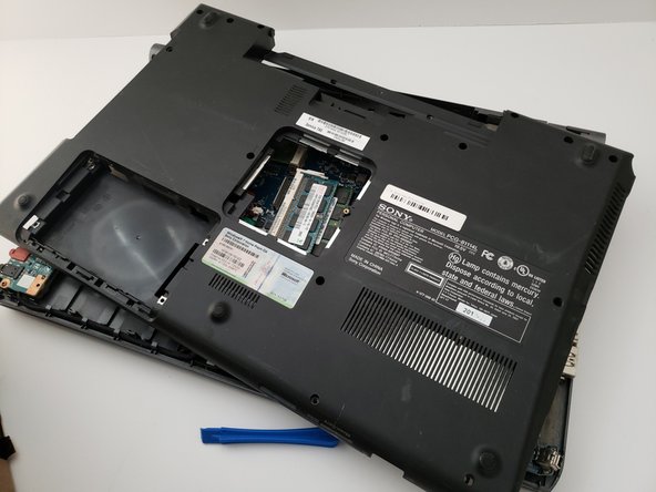

  10. Sony Vaio VPCF115FM Back Panel Assembly Replacement: crwdns2935265:010crwdnd2935265:01crwdnd2935265:01crwdne2935265:0
    • Remove the rest of the twelve 9mm Phillips #1 screws on the back panel.
    • Remove the final screw.

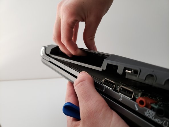

  11. Sony Vaio VPCF115FM Back Panel Assembly Replacement: crwdns2935265:011crwdnd2935265:01crwdnd2935265:03crwdne2935265:0 Sony Vaio VPCF115FM Back Panel Assembly Replacement: crwdns2935265:011crwdnd2935265:02crwdnd2935265:03crwdne2935265:0 Sony Vaio VPCF115FM Back Panel Assembly Replacement: crwdns2935265:011crwdnd2935265:03crwdnd2935265:03crwdne2935265:0
    • Using an iFixit opening tool, pry the back panel off.
    • At this point, the back panel should very easily pop off.
    • Be careful around mechanical components on the edges of the laptop (audio output, USB ports).

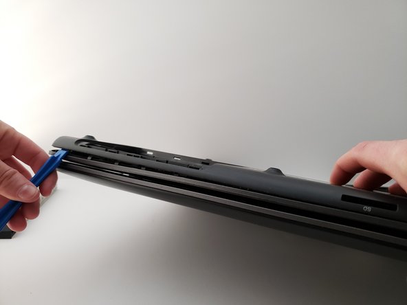

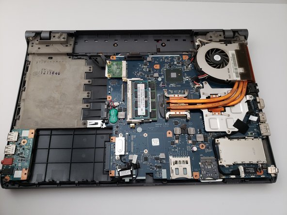

  12. Sony Vaio VPCF115FM Back Panel Assembly Replacement: crwdns2935265:012crwdnd2935265:01crwdnd2935265:03crwdne2935265:0 Sony Vaio VPCF115FM Back Panel Assembly Replacement: crwdns2935265:012crwdnd2935265:02crwdnd2935265:03crwdne2935265:0 Sony Vaio VPCF115FM Back Panel Assembly Replacement: crwdns2935265:012crwdnd2935265:03crwdnd2935265:03crwdne2935265:0
    • Continue popping the back panel off.
    • The back panel should now be off.

The fan ran at high speed and the laptop would randomly shut down. I suspected a cooling problem. Turned out there was a layer of dust caked on the “fan side” of the cooling fins. I removed the fan/heat sink assembly and used a vacuum and an artist’s brush to clean the fins and fan blades. Put a fresh layer of thermal compound on the CPU and GPU heat sinks and reassembled everything. This back panel removal/replacement instruction page was a great help. Everything went back together successfully and, to my amazement, there were no screws left over!
