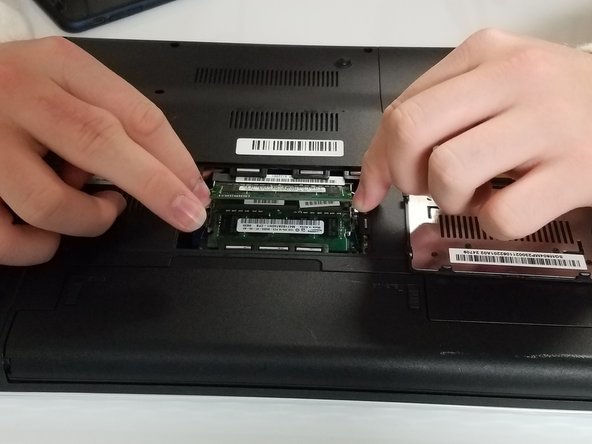

    • Use a Phillips #00 screwdriver to unscrew the single RAM cover screw.
  2. Sony Vaio VPCEL17FX RAM Sticks Replacement: crwdns2935265:02crwdnd2935265:01crwdnd2935265:01crwdne2935265:0
    • Pull the cover of the RAM sticks up.
  3. Sony Vaio VPCEL17FX RAM Sticks Replacement: crwdns2935265:03crwdnd2935265:01crwdnd2935265:02crwdne2935265:0 Sony Vaio VPCEL17FX RAM Sticks Replacement: crwdns2935265:03crwdnd2935265:02crwdnd2935265:02crwdne2935265:0

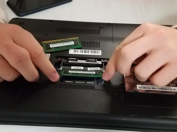

    • Pull apart the metal sides on the sides of the top RAM stick to pop it up.
    • Repeat that process with the bottom RAM stick.

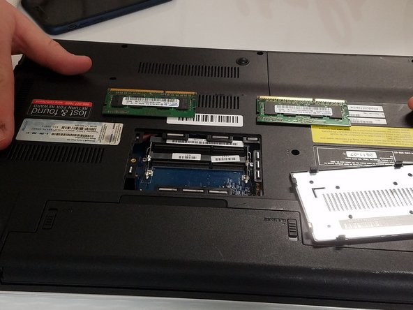

    • Remove both RAM sticks.
    • Take care removing the RAM sticks as they are fragile.
