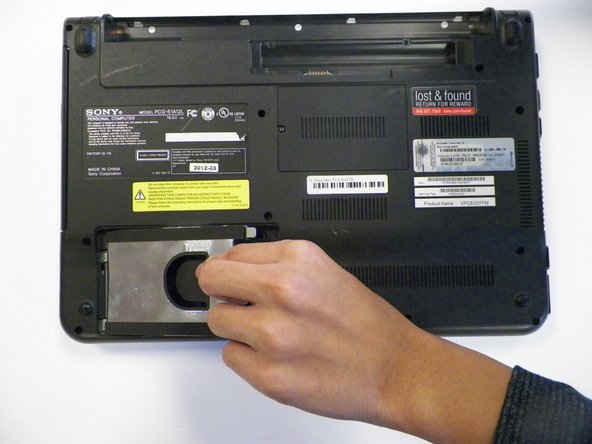

  3. Sony Vaio VPCEG37FM Hard Drive Replacement, Hard Drive: crwdns2935265:03crwdnd2935265:01crwdnd2935265:01crwdne2935265:0
    • Using a Phillips #1 screwdriver, remove the 2 6.5mm screws around the hard drive case.
    • The screws are attached to the hard drive case.
  4. Sony Vaio VPCEG37FM Hard Drive Replacement: crwdns2935265:04crwdnd2935265:01crwdnd2935265:01crwdne2935265:0
    • Gently remove the hard drive case to expose the actual hard drive.
    • Be sure that the two screws are completely unscrewed before removing to not damage any of the parts.
  5. Sony Vaio VPCEG37FM Hard Drive Replacement: crwdns2935265:05crwdnd2935265:01crwdnd2935265:02crwdne2935265:0 Sony Vaio VPCEG37FM Hard Drive Replacement: crwdns2935265:05crwdnd2935265:02crwdnd2935265:02crwdne2935265:0
    • To remove the hard drive, slide the hard drive forward and lift up.
    • The hard drive should come out easily with little to no resistance.
