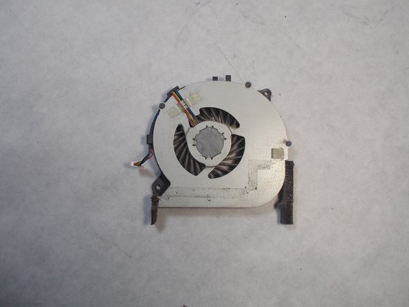

  7. Sony Vaio VPCEG26FX Fan Replacement, Fan: crwdns2935265:07crwdnd2935265:01crwdnd2935265:01crwdne2935265:0
    • Remove the three 7mm screws attached to the fan using the JIS #0 screwdriver.
  8. Sony Vaio VPCEG26FX Fan Replacement: crwdns2935265:08crwdnd2935265:01crwdnd2935265:03crwdne2935265:0 Sony Vaio VPCEG26FX Fan Replacement: crwdns2935265:08crwdnd2935265:02crwdnd2935265:03crwdne2935265:0 Sony Vaio VPCEG26FX Fan Replacement: crwdns2935265:08crwdnd2935265:03crwdnd2935265:03crwdne2935265:0
    • Unplug and remove the Fan.
