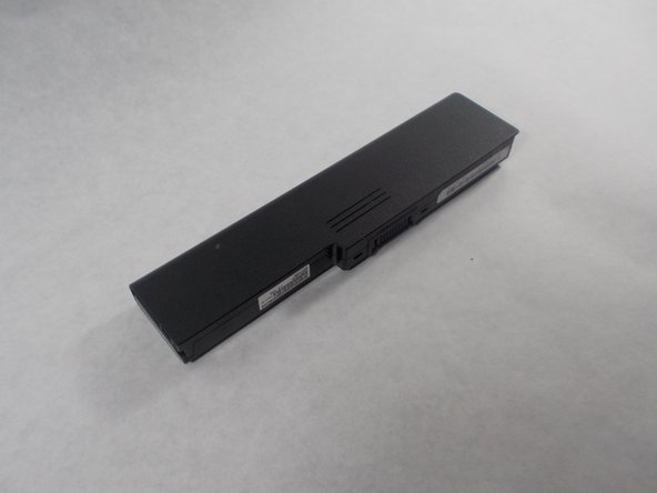

    • Flip the laptop so the bottom is facing up with the model number visible.
  2. Sony Vaio VPCEG26FX Battery Replacement: crwdns2935265:02crwdnd2935265:01crwdnd2935265:02crwdne2935265:0 Sony Vaio VPCEG26FX Battery Replacement: crwdns2935265:02crwdnd2935265:02crwdnd2935265:02crwdne2935265:0
    • Slide the lock switch down until you hear a click to unlock the battery.
  3. Sony Vaio VPCEG26FX Battery Replacement: crwdns2935265:03crwdnd2935265:01crwdnd2935265:02crwdne2935265:0 Sony Vaio VPCEG26FX Battery Replacement: crwdns2935265:03crwdnd2935265:02crwdnd2935265:02crwdne2935265:0
    • Slide the release slider up and simultaneously push the battery upwards away from the device until it falls out of place.
  4. Sony Vaio VPCEG26FX Battery Replacement: crwdns2935265:04crwdnd2935265:01crwdnd2935265:02crwdne2935265:0 Sony Vaio VPCEG26FX Battery Replacement: crwdns2935265:04crwdnd2935265:02crwdnd2935265:02crwdne2935265:0
    • Remove the battery from the battery compartment.
