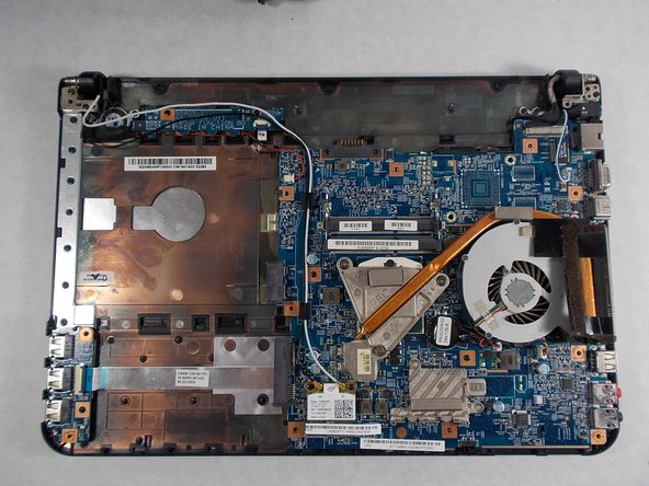

  12. Sony Vaio VPCEG26FX Back Panel Replacement, Back Panel: crwdns2935265:012crwdnd2935265:01crwdnd2935265:01crwdne2935265:0
    • Remove the remaining eleven 7mm screws from back panel using the JIS #0 screwdriver.
  13. Sony Vaio VPCEG26FX Back Panel Replacement: crwdns2935265:013crwdnd2935265:01crwdnd2935265:02crwdne2935265:0 Sony Vaio VPCEG26FX Back Panel Replacement: crwdns2935265:013crwdnd2935265:02crwdnd2935265:02crwdne2935265:0
    • Remove the back panel from the device.
