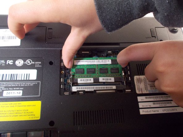

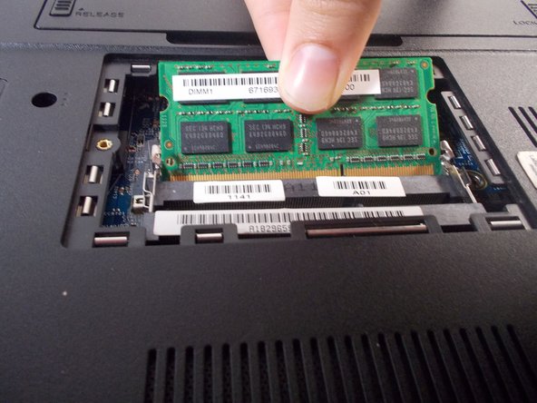

  5. Sony Vaio VPCEG26FX  RAM Replacement, RAM: crwdns2935265:05crwdnd2935265:01crwdnd2935265:01crwdne2935265:0
    • After you remove the battery, there is a small rectangular panel underneath where the battery was housed.
  6. Sony Vaio VPCEG26FX  RAM Replacement: crwdns2935265:06crwdnd2935265:01crwdnd2935265:01crwdne2935265:0
    • Remove the single screw holding the panel in place using the JIS #0 screwdriver.
  7. Sony Vaio VPCEG26FX  RAM Replacement: crwdns2935265:07crwdnd2935265:01crwdnd2935265:03crwdne2935265:0 Sony Vaio VPCEG26FX  RAM Replacement: crwdns2935265:07crwdnd2935265:02crwdnd2935265:03crwdne2935265:0 Sony Vaio VPCEG26FX  RAM Replacement: crwdns2935265:07crwdnd2935265:03crwdnd2935265:03crwdne2935265:0
    • Remove the green circuit board by dislodging the circuit it is attached to.
    • Unhook it and remove it from the device.
