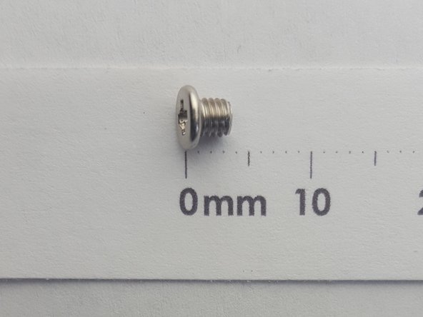

    • Using the Phillips #01 Screwdriver, remove the two 7mm screws.

    • Remove the 3mm screws with the Phillips #1 Screwdriver from hard drive bracket.

    • Remove the 7mm screws with the Phillips #1 Screwdriver.

    • Remove ten 7mm screws with the Phillips #1 Screwdriver.
    • Remove two 8mm screws with the Phillips #1 Screwdriver.
    • Remove two 3mm screws with the Phillips #1 Screwdriver.
