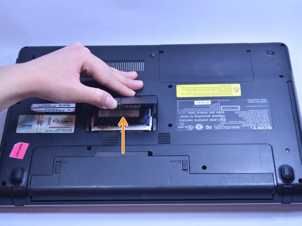

  4. Sony Vaio VPCEB11FM RAM Replacement, RAM: crwdns2935265:04crwdnd2935265:01crwdnd2935265:02crwdne2935265:0 Sony Vaio VPCEB11FM RAM Replacement, RAM: crwdns2935265:04crwdnd2935265:02crwdnd2935265:02crwdne2935265:0
    • Unscrew the RAM cover plate using the Phillips #1 Screwdriver.
    • Once the cover has been loosened, pry the cover with your finger for it to come off.
  5. Sony Vaio VPCEB11FM RAM Replacement: crwdns2935265:05crwdnd2935265:01crwdnd2935265:03crwdne2935265:0 Sony Vaio VPCEB11FM RAM Replacement: crwdns2935265:05crwdnd2935265:02crwdnd2935265:03crwdne2935265:0 Sony Vaio VPCEB11FM RAM Replacement: crwdns2935265:05crwdnd2935265:03crwdnd2935265:03crwdne2935265:0
    • Use your fingers to gently pull the white plastic strip outward on both sides.
    • Once you pull the strip, the strip of RAM will loosen up. Once loose the strip of RAM should lift out.
    • Once done with the top strip of RAM continue for all continuous strips.
