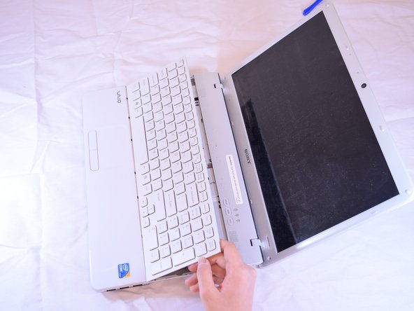

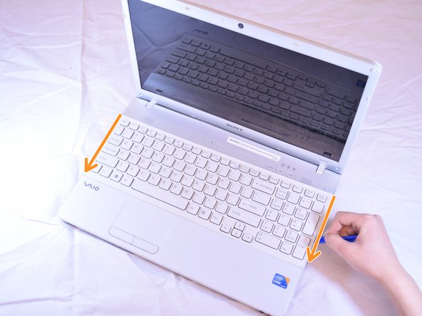

  6. Sony Vaio VPCEB11FM Keyboard Replacement, Keyboard: crwdns2935265:06crwdnd2935265:01crwdnd2935265:03crwdne2935265:0 Sony Vaio VPCEB11FM Keyboard Replacement, Keyboard: crwdns2935265:06crwdnd2935265:02crwdnd2935265:03crwdne2935265:0 Sony Vaio VPCEB11FM Keyboard Replacement, Keyboard: crwdns2935265:06crwdnd2935265:03crwdnd2935265:03crwdne2935265:0
    • Within the DVD drive compartment, press on the hole to push the keyboard out of its placement.
    • The keyboard may need to be loosened on its edges with a plastic spudger.

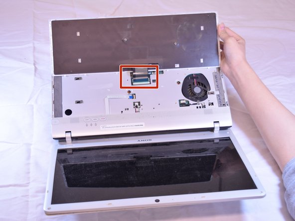

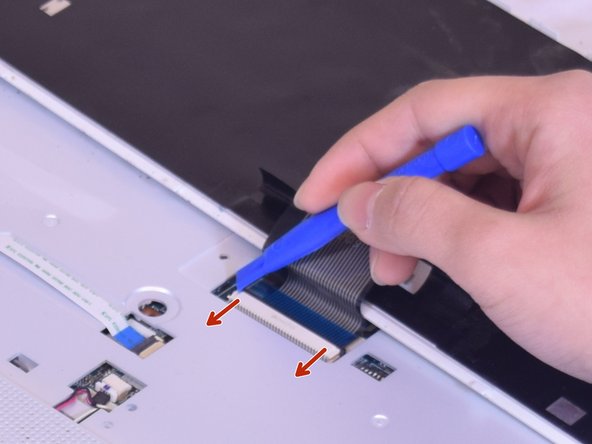

  7. Sony Vaio VPCEB11FM Keyboard Replacement: crwdns2935265:07crwdnd2935265:01crwdnd2935265:03crwdne2935265:0 Sony Vaio VPCEB11FM Keyboard Replacement: crwdns2935265:07crwdnd2935265:02crwdnd2935265:03crwdne2935265:0 Sony Vaio VPCEB11FM Keyboard Replacement: crwdns2935265:07crwdnd2935265:03crwdnd2935265:03crwdne2935265:0
    • Carefully pull the keyboard back to expose ribbon connector.
    • Using a spudger, or your finger tips, carefully slide the the ribbon keeper open.
