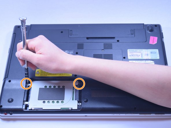

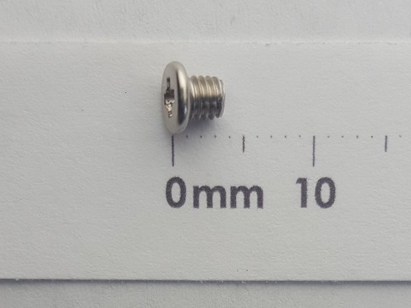

  6. Sony Vaio VPCEB11FM Cooling Fan Replacement, Hard Drive: crwdns2935265:06crwdnd2935265:01crwdnd2935265:02crwdne2935265:0 Sony Vaio VPCEB11FM Cooling Fan Replacement, Hard Drive: crwdns2935265:06crwdnd2935265:02crwdnd2935265:02crwdne2935265:0
    • Using the Phillips #01 Screwdriver, remove the two 7mm screws.

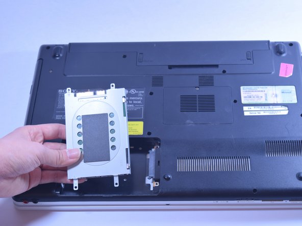

  8. Sony Vaio VPCEB11FM Cooling Fan Replacement: crwdns2935265:08crwdnd2935265:01crwdnd2935265:02crwdne2935265:0 Sony Vaio VPCEB11FM Cooling Fan Replacement: crwdns2935265:08crwdnd2935265:02crwdnd2935265:02crwdne2935265:0
    • Lift plug side first.
    • Remove all the way.

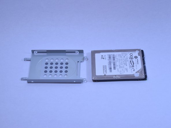

  9. Sony Vaio VPCEB11FM Cooling Fan Replacement: crwdns2935265:09crwdnd2935265:01crwdnd2935265:03crwdne2935265:0 Sony Vaio VPCEB11FM Cooling Fan Replacement: crwdns2935265:09crwdnd2935265:02crwdnd2935265:03crwdne2935265:0 Sony Vaio VPCEB11FM Cooling Fan Replacement: crwdns2935265:09crwdnd2935265:03crwdnd2935265:03crwdne2935265:0
    • Skip to next step if accessing other components.

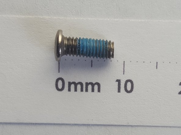

    • Remove the 3mm screws with the Phillips #1 Screwdriver from hard drive bracket.

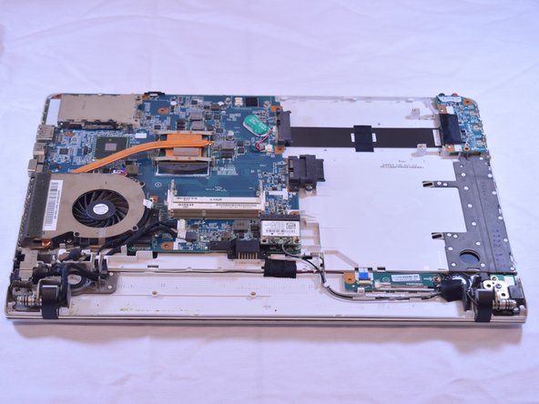

  12. Sony Vaio VPCEB11FM Cooling Fan Replacement, Cooling Fan: crwdns2935265:012crwdnd2935265:01crwdnd2935265:03crwdne2935265:0 Sony Vaio VPCEB11FM Cooling Fan Replacement, Cooling Fan: crwdns2935265:012crwdnd2935265:02crwdnd2935265:03crwdne2935265:0 Sony Vaio VPCEB11FM Cooling Fan Replacement, Cooling Fan: crwdns2935265:012crwdnd2935265:03crwdnd2935265:03crwdne2935265:0

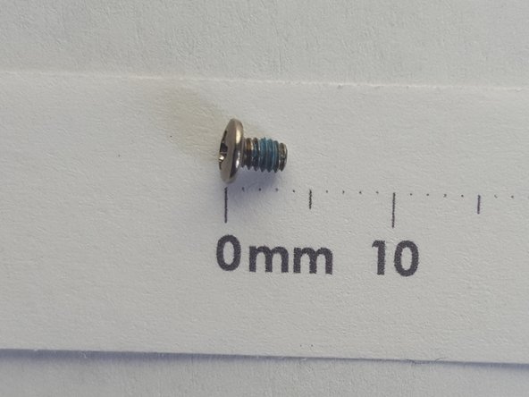

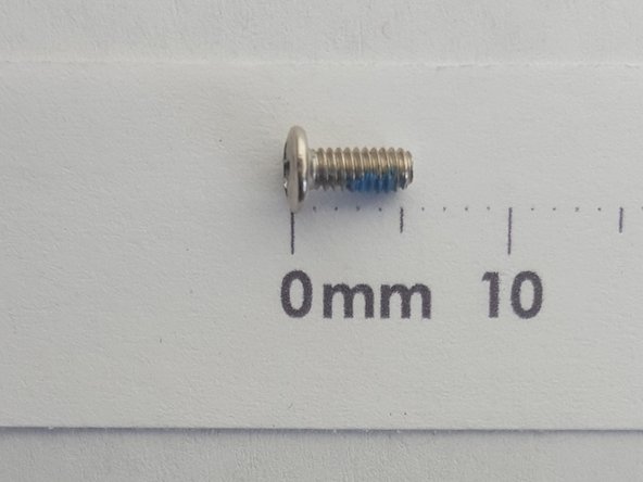

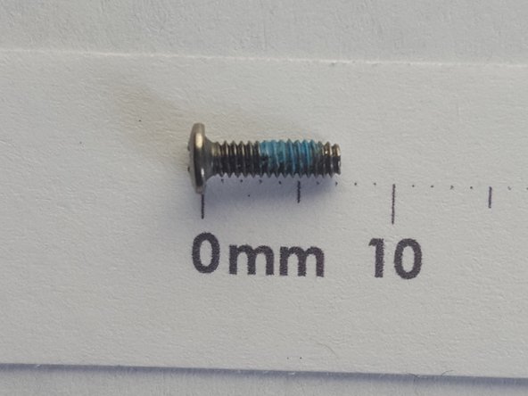

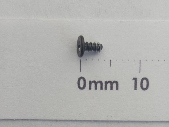

    • Remove ten 7mm screws with the Phillips #1 Screwdriver.
    • Remove two 8mm screws with the Phillips #1 Screwdriver.
    • Remove two 3mm screws with the Phillips #1 Screwdriver.
  13. Sony Vaio VPCEB11FM Cooling Fan Replacement: crwdns2935265:013crwdnd2935265:01crwdnd2935265:02crwdne2935265:0 Sony Vaio VPCEB11FM Cooling Fan Replacement: crwdns2935265:013crwdnd2935265:02crwdnd2935265:02crwdne2935265:0
    • Remove SD card slot block by pushing it in until it releases.
    • Once released pull out to remove.

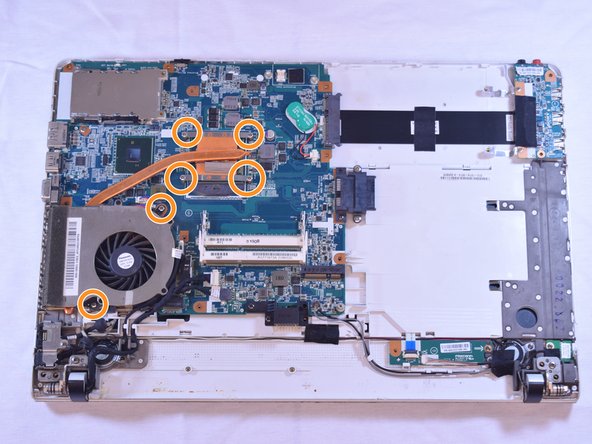

  15. Sony Vaio VPCEB11FM Cooling Fan Replacement: crwdns2935265:015crwdnd2935265:01crwdnd2935265:03crwdne2935265:0 Sony Vaio VPCEB11FM Cooling Fan Replacement: crwdns2935265:015crwdnd2935265:02crwdnd2935265:03crwdne2935265:0 Sony Vaio VPCEB11FM Cooling Fan Replacement: crwdns2935265:015crwdnd2935265:03crwdnd2935265:03crwdne2935265:0
    • Remove the plug shown using a pry tool.
    • Remove seven 5mm screws with the Phillips #01 Screwdriver.

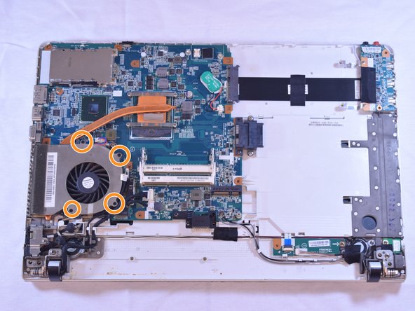

  16. Sony Vaio VPCEB11FM Cooling Fan Replacement: crwdns2935265:016crwdnd2935265:01crwdnd2935265:03crwdne2935265:0 Sony Vaio VPCEB11FM Cooling Fan Replacement: crwdns2935265:016crwdnd2935265:02crwdnd2935265:03crwdne2935265:0 Sony Vaio VPCEB11FM Cooling Fan Replacement: crwdns2935265:016crwdnd2935265:03crwdnd2935265:03crwdne2935265:0
    • To break the thermal paste, apply gentle constant upward force until it comes free.
    • Remove four 3.5mm screws with the Phillips #000 Screwdriver to access cooling fan.
