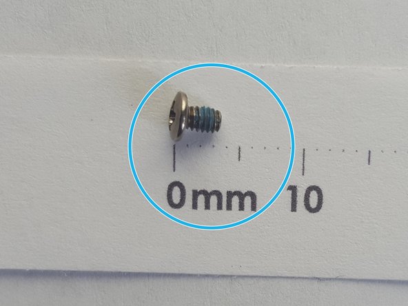

  6. Sony Vaio VPCEB11FM Audio Card Replacement, Hard Drive: crwdns2935265:06crwdnd2935265:01crwdnd2935265:02crwdne2935265:0 Sony Vaio VPCEB11FM Audio Card Replacement, Hard Drive: crwdns2935265:06crwdnd2935265:02crwdnd2935265:02crwdne2935265:0
    • Using the Phillips #01 Screwdriver, remove the two 7mm screws.
  7. Sony Vaio VPCEB11FM Audio Card Replacement: crwdns2935265:07crwdnd2935265:01crwdnd2935265:03crwdne2935265:0 Sony Vaio VPCEB11FM Audio Card Replacement: crwdns2935265:07crwdnd2935265:02crwdnd2935265:03crwdne2935265:0 Sony Vaio VPCEB11FM Audio Card Replacement: crwdns2935265:07crwdnd2935265:03crwdnd2935265:03crwdne2935265:0

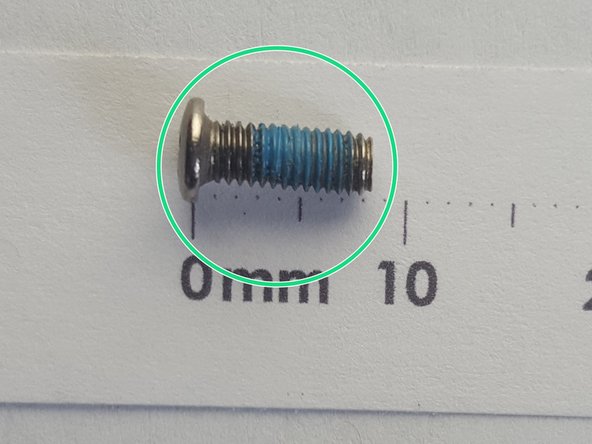

  9. Sony Vaio VPCEB11FM Audio Card Replacement: crwdns2935265:09crwdnd2935265:01crwdnd2935265:03crwdne2935265:0 Sony Vaio VPCEB11FM Audio Card Replacement: crwdns2935265:09crwdnd2935265:02crwdnd2935265:03crwdne2935265:0 Sony Vaio VPCEB11FM Audio Card Replacement: crwdns2935265:09crwdnd2935265:03crwdnd2935265:03crwdne2935265:0
    • Skip to next step if accessing other components.
    • Remove the 3mm screws with the Phillips #1 Screwdriver from hard drive bracket.

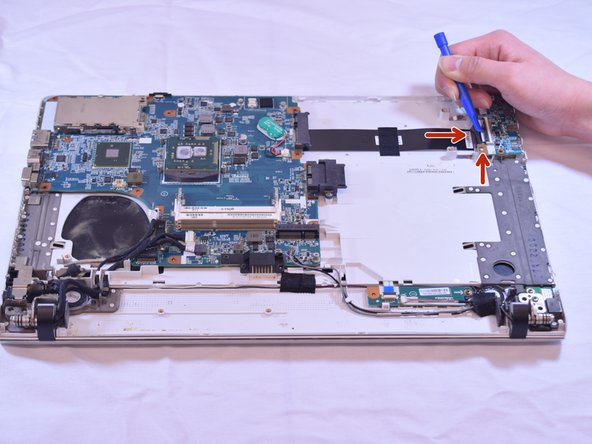

  10. Sony Vaio VPCEB11FM Audio Card Replacement, Audio Card: crwdns2935265:010crwdnd2935265:01crwdnd2935265:03crwdne2935265:0 Sony Vaio VPCEB11FM Audio Card Replacement, Audio Card: crwdns2935265:010crwdnd2935265:02crwdnd2935265:03crwdne2935265:0 Sony Vaio VPCEB11FM Audio Card Replacement, Audio Card: crwdns2935265:010crwdnd2935265:03crwdnd2935265:03crwdne2935265:0
    • #1 Unscrew the back panel
    • #2 Then work the tool around the sides to release cover. You may need a second tool to help keep your loose corner open.
  11. Sony Vaio VPCEB11FM Audio Card Replacement: crwdns2935265:011crwdnd2935265:01crwdnd2935265:03crwdne2935265:0 Sony Vaio VPCEB11FM Audio Card Replacement: crwdns2935265:011crwdnd2935265:02crwdnd2935265:03crwdne2935265:0 Sony Vaio VPCEB11FM Audio Card Replacement: crwdns2935265:011crwdnd2935265:03crwdnd2935265:03crwdne2935265:0
    • Unscrew the screw with the size of * screw driver
    • Left up the case holder
    • Gently pull the connective cable
