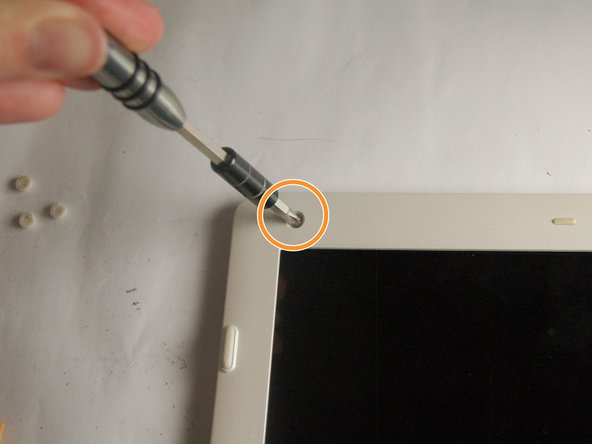

  4. Sony Vaio VPCCW17FX Webcam Replacement: crwdns2935265:04crwdnd2935265:01crwdnd2935265:02crwdne2935265:0 Sony Vaio VPCCW17FX Webcam Replacement: crwdns2935265:04crwdnd2935265:02crwdnd2935265:02crwdne2935265:0
    • Remove the four rubber circles using the spudger located on each corner of the laptop.
    • Remove the four screws (Length: 7.7 mm) using the Phillips #0 screwdriver that are located under each rubber circle.

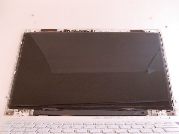

  5. Sony Vaio VPCCW17FX Webcam Replacement: crwdns2935265:05crwdnd2935265:01crwdnd2935265:02crwdne2935265:0 Sony Vaio VPCCW17FX Webcam Replacement: crwdns2935265:05crwdnd2935265:02crwdnd2935265:02crwdne2935265:0
    • Slowly peel off the plastic covering around the screen.
    • Place it to the side once it is completely disconnected.
    • You may need to apply slight pressure to release the clips of the covering.
  6. Sony Vaio VPCCW17FX Webcam Replacement: crwdns2935265:06crwdnd2935265:01crwdnd2935265:03crwdne2935265:0 Sony Vaio VPCCW17FX Webcam Replacement: crwdns2935265:06crwdnd2935265:02crwdnd2935265:03crwdne2935265:0 Sony Vaio VPCCW17FX Webcam Replacement: crwdns2935265:06crwdnd2935265:03crwdnd2935265:03crwdne2935265:0
    • Remove the two screws (Length: 7.7 mm) using the Phillips #0 screwdriver that hold the Webcam in place.
    • Gently pull the webcam away from the laptop.
    • Slowly disconnect the two ribbon cable connectors by sliding them towards the wire to disconnect the webcam from the laptop.
