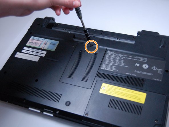

    • Using a Phillips #0 screwdriver to remove the two screws (Length: 7.7 mm) of the Hard Drive cover and place the cover to the side.
    • Using a Phillips #0 screwdriver, remove the one screw (Length: 7.7 mm) from the RAM cover and place it to the side.

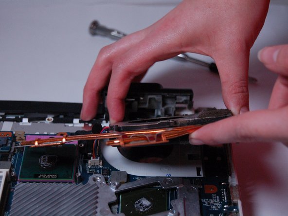

    • Locate the fan and use a Phillips #0 screwdriver, remove the two screws (Length: 7.7 mm) that hold it in place.
    • Lift the fan and move it out of the way.

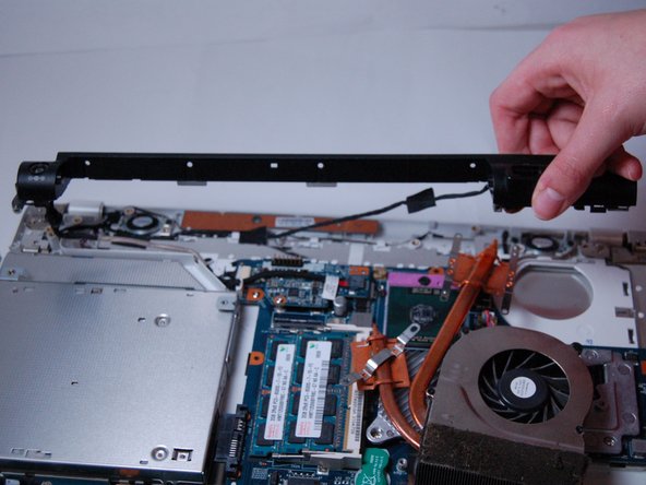

    • Begin removing the four screws with a Phillips #0 screwdriver (Length: 7.7 mm) from the back cover.
    • Place the cover out of the way.
    • Be careful to not pull any wires out while moving the cover.

    • Using a Phillips #0 screwdriver, remove the two screws (Length: 7.7 mm) that hold the speaker in place.
    • Follow the wire until you find the ribbon cable that holds the wires and pull straight out of the connect to remove it.
    • You are now free to replace the speakers.
    • There are two speakers so be sure to repeat the same steps for the second speaker.
