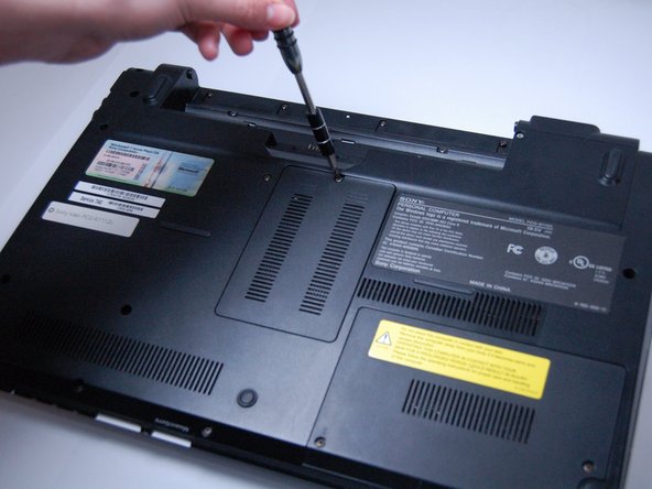

      • Using a Phillips #0 screwdriver, remove the one screw (Length: 7.7 mm) that is covering the RAM.
    5. Sony Vaio VPCCW17FX RAM Replacement: crwdns2935265:05crwdnd2935265:01crwdnd2935265:01crwdne2935265:0
      • Lift the black plastic cover to assess the RAM.

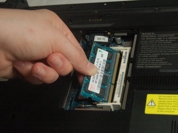

      • Apply light, outward pressure to the locks on both sides of the RAM.
      • Rotate the RAM up and slowly pull towards you to remove it.
    7. Sony Vaio VPCCW17FX RAM Replacement: crwdns2935265:07crwdnd2935265:01crwdnd2935265:03crwdne2935265:0 Sony Vaio VPCCW17FX RAM Replacement: crwdns2935265:07crwdnd2935265:02crwdnd2935265:03crwdne2935265:0 Sony Vaio VPCCW17FX RAM Replacement: crwdns2935265:07crwdnd2935265:03crwdnd2935265:03crwdne2935265:0
      • In order to remove the secondary RAM, use the same outward pressure on the locks.
      • Lift and slide out the RAM to remove it from the slot.
