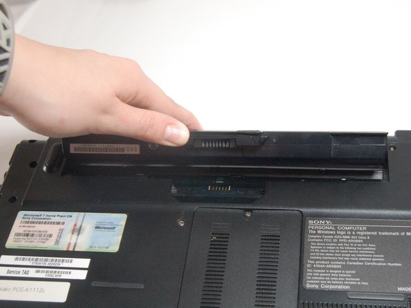

      • Turn the laptop over and orient it as shown.
    2. Sony Vaio VPCCW17FX LCD Screen Replacement: crwdns2935265:02crwdnd2935265:01crwdnd2935265:01crwdne2935265:0
      • Slide both latches towards the center of the battery to release.
    3. Sony Vaio VPCCW17FX LCD Screen Replacement: crwdns2935265:03crwdnd2935265:01crwdnd2935265:02crwdne2935265:0 Sony Vaio VPCCW17FX LCD Screen Replacement: crwdns2935265:03crwdnd2935265:02crwdnd2935265:02crwdne2935265:0
      • Use your fingernail or a plastic tool to lift the battery. Rotate the battery up and away to remove from the laptop.

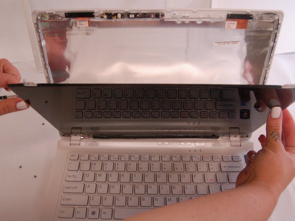

    6. Sony Vaio VPCCW17FX LCD Screen Replacement: crwdns2935265:06crwdnd2935265:01crwdnd2935265:02crwdne2935265:0 Sony Vaio VPCCW17FX LCD Screen Replacement: crwdns2935265:06crwdnd2935265:02crwdnd2935265:02crwdne2935265:0
      • Remove all four screws (Length: 7.7 mm) using a Phillips #0 screwdriver. Make sure to hold the screen while removing the screws so it doesn't fall.
      • Using your thumb, carefully lower the glass and place it on the keyboard.
      • Do this slowly to avoid damaging the screen.

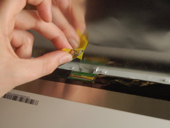

      • Pull off the tape and disconnect the display cable connector by gently sliding up to remove it from its socket.
