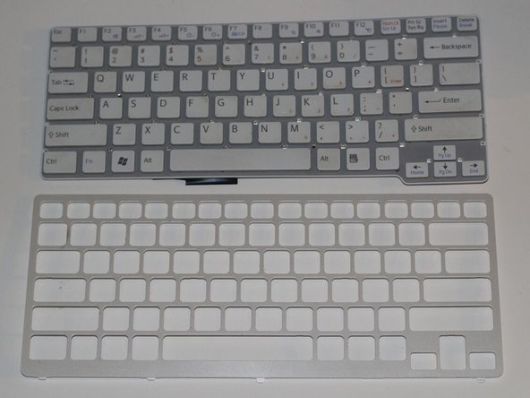

  17. Sony Vaio VPCCW17FX Keyboard  Replacement, Keyboard: crwdns2935265:017crwdnd2935265:01crwdnd2935265:01crwdne2935265:0
    • Using the Phillips #00 screwdriver, remove the one 3.7 mm screw that secures the keyboard to the laptop.
    • It is possible that you already removed this screw while removing the other motherboard screws. If this is the case, proceed to the next steps.

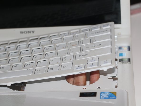

  18. Sony Vaio VPCCW17FX Keyboard  Replacement: crwdns2935265:018crwdnd2935265:01crwdnd2935265:03crwdne2935265:0 Sony Vaio VPCCW17FX Keyboard  Replacement: crwdns2935265:018crwdnd2935265:02crwdnd2935265:03crwdne2935265:0 Sony Vaio VPCCW17FX Keyboard  Replacement: crwdns2935265:018crwdnd2935265:03crwdnd2935265:03crwdne2935265:0
    • Using your hand, gently apply pressure to the bottom of the keyboard via the two silver openings in the computer frame.
    • This will release the keyboard from the computer.
