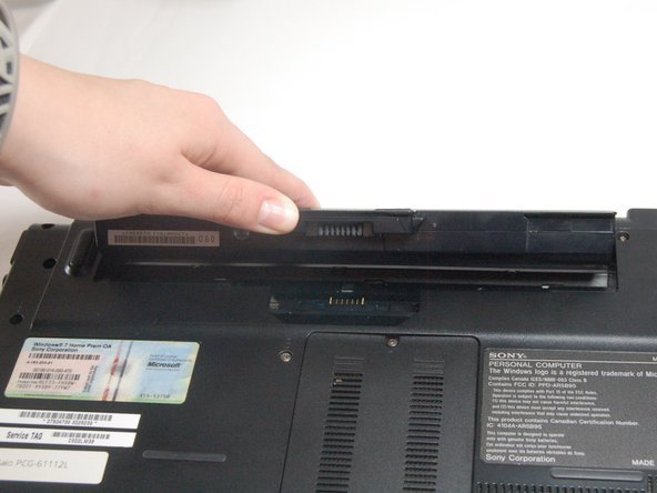

    • Slide the two latches towards the center of the battery to release it.
  3. Sony Vaio VPCCW17FX Hard Drive Replacement: crwdns2935265:03crwdnd2935265:01crwdnd2935265:02crwdne2935265:0 Sony Vaio VPCCW17FX Hard Drive Replacement: crwdns2935265:03crwdnd2935265:02crwdnd2935265:02crwdne2935265:0
    • Use your fingernail or a plastic tool to lift the battery. Rotate the battery up and away to remove from the laptop.

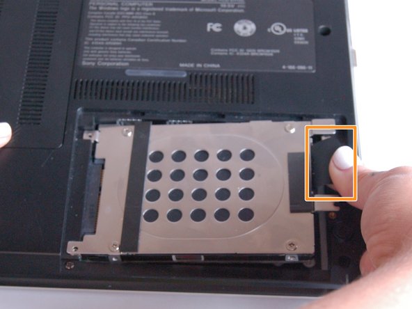

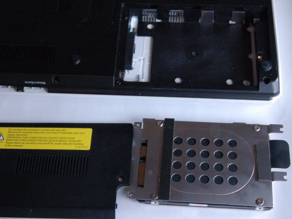

    • Use a Phillips #00 screwdriver to remove the two 7.7 mm screws from the hard drive cover and place it to the side.
  5. Sony Vaio VPCCW17FX Hard Drive Replacement: crwdns2935265:05crwdnd2935265:01crwdnd2935265:03crwdne2935265:0 Sony Vaio VPCCW17FX Hard Drive Replacement: crwdns2935265:05crwdnd2935265:02crwdnd2935265:03crwdne2935265:0 Sony Vaio VPCCW17FX Hard Drive Replacement: crwdns2935265:05crwdnd2935265:03crwdnd2935265:03crwdne2935265:0
    • Remove the four screws (Length: 7.7 mm) using the Phillips #00 screwdriver that hold the hard drive in place.
    • Use the tab to slide the hard drive away from the laptop.
    • Set the disconnected hard drive away from the laptop.

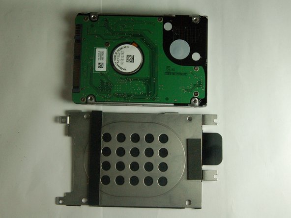

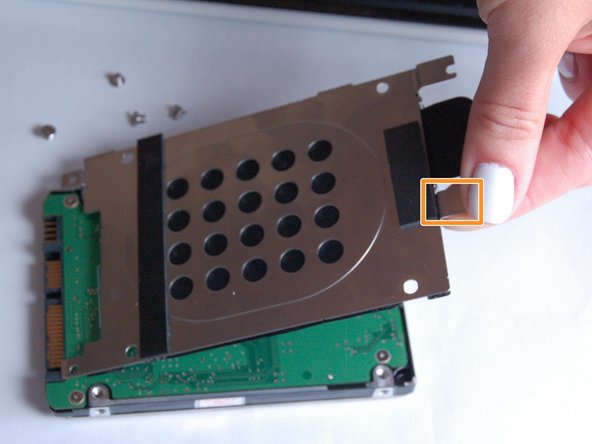

  6. Sony Vaio VPCCW17FX Hard Drive Replacement: crwdns2935265:06crwdnd2935265:01crwdnd2935265:03crwdne2935265:0 Sony Vaio VPCCW17FX Hard Drive Replacement: crwdns2935265:06crwdnd2935265:02crwdnd2935265:03crwdne2935265:0 Sony Vaio VPCCW17FX Hard Drive Replacement: crwdns2935265:06crwdnd2935265:03crwdnd2935265:03crwdne2935265:0
    • Remove the four screws (Length: 7.7 mm) using the Phillips #00 screwdriver that cover the hard drive.
    • Use the tab to pull up on the metal cover and remove it.
    • You are now free to replace the hard drive.
